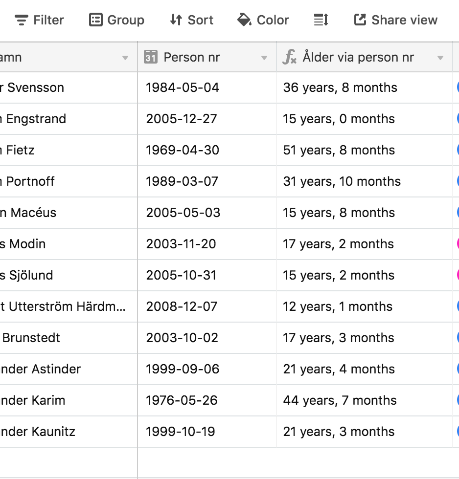

Hi, i need help with a formula if this is possible.
i have a table containing a “date” field and a “formula” field that calculates the age from that.
( DATETIME_DIFF(TODAY(), {Person nr}, ‘years’) & ’ years, ’ & MOD(DATETIME_DIFF(TODAY(), {Person nr}, ‘months’), 12) & ’ months’ )

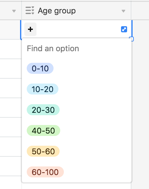

everything is perfect here so far, but i would like to make a new field that contains age groups,
like 0-10, 10-18, 18-30, 30-50, 50-100 lets say. is there a formula for making this? and can it change buy it self when a person goes from let say age 29 to 30 and so on?
or
is there a way to search, filter or group already for lets say ages between 20-40 or 30 and up? or 25-45?
Hope you understand what i am looking for, and every help i can get would be much appreciated!
Thanks,
Viktor

sorry if im not understanding correctly, but the output is for example
36 years, 8 months
36 years, 8 months

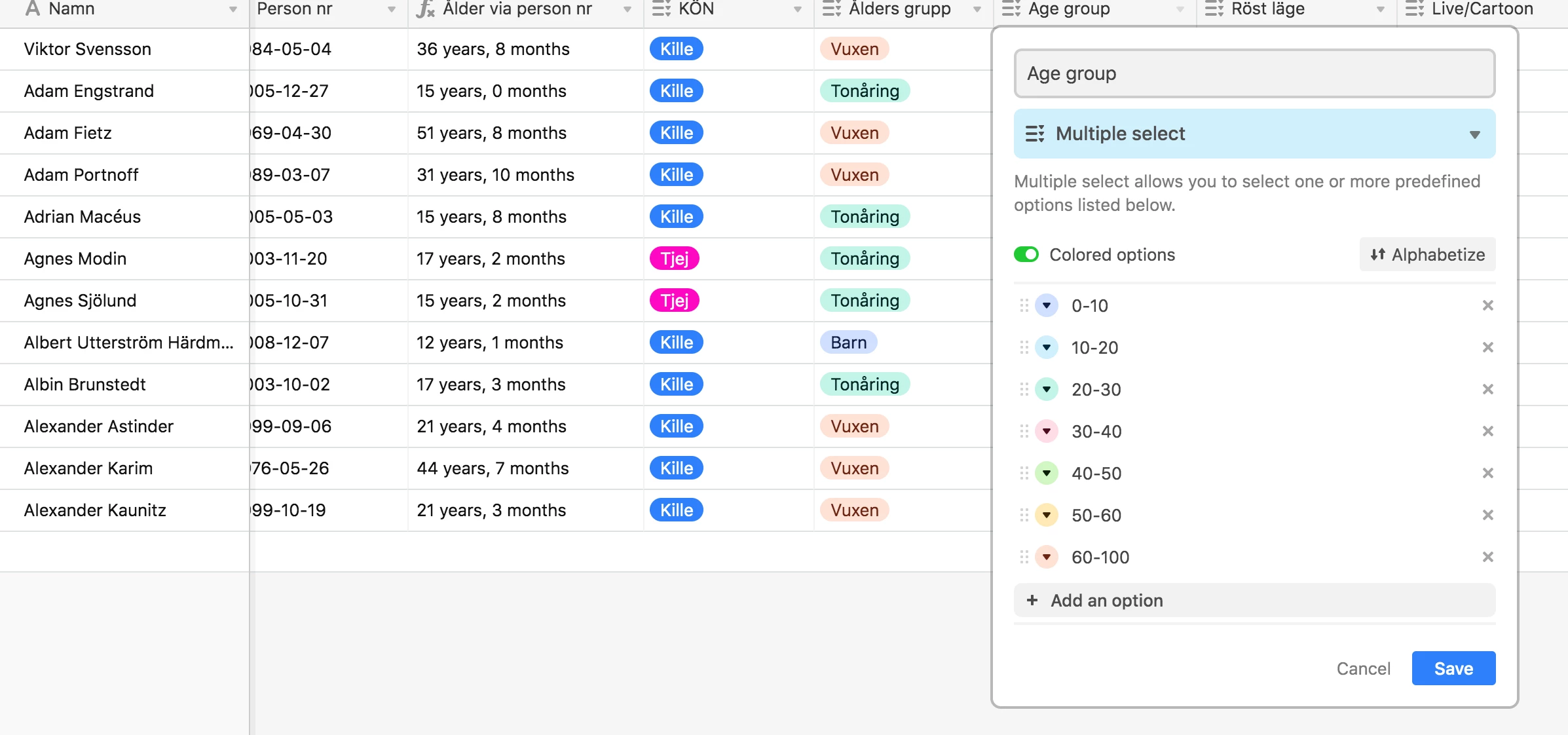

I worked this out in my test base. So here is my suggestion.
The Formula that is returning the Age in Years and Months needs to be just a single number. If you want to keep that field as is for readable purposes that’s find but you are going to need another field that outputs the age as a single number I recommend in days.
Then you can use an Airtable automation. When a Record Matches Condition - WHEN {Age Formatted in Days} > (The number of days in the min of the age group). AND {Age Formatted in Days} < (The number of days in the max of the age group).
@Viktor_Svensson You will need an automation for each age group. So 7 automations in your case.
The action would be Update Record - The field would be your single select with the option typed in as exactly how it is in the single select.
Does that make sense? This may not be the best way to do it but it will work

Thank you for helping me! much appreciated. if there is possible without automations that would be great, but if thats the way, then thats fine too.
and if my setup is not the best, that can change too. so if there is another way to have “age” and “age groups” that would be more then ok. i can start all over.
