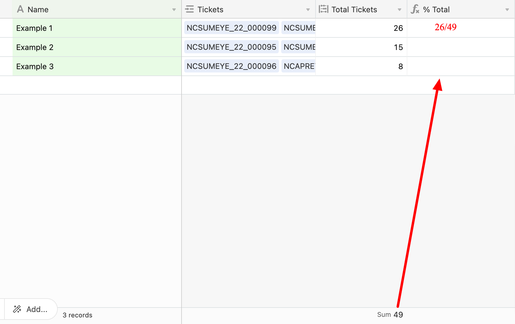

Hi there Airtable folks!
I'm trying to wrap my head around a simple calculation - but I'm not sure how this can be done.
I'd like to calculate the % of total of a given column, I know I can input a constant number into the formula but the table will increase it records, so it has to be calculated.
Essentially I want to perform the following, take each number and divide it by the total.
Is there a way to do that?
Thanks a lot!
