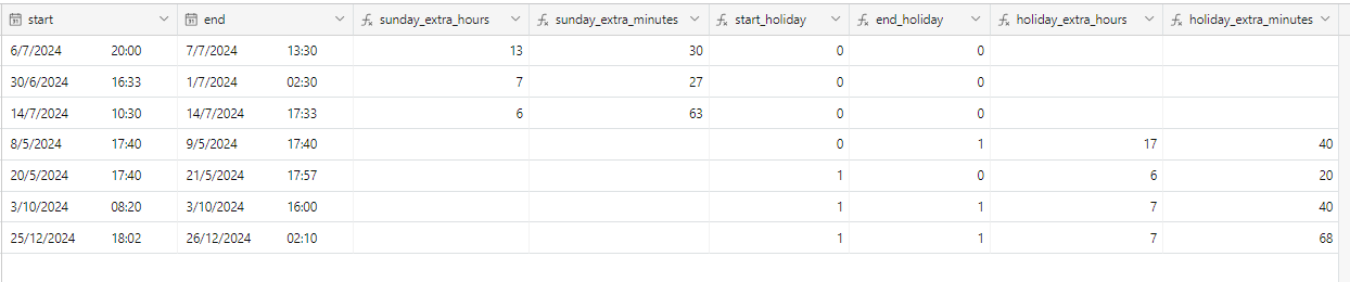

Here is my table:
First point is that I had to set dates format as follows:
Field "sunday_extra_hours" is the formula:
IF(AND(WEEKDAY(start)=0,WEEKDAY(end)=0),HOUR(end)-HOUR(start)-1,
IF(WEEKDAY(start)=0,23-HOUR(start),
IF(WEEKDAY(end)=0,HOUR(end)
Field "sunday_extra_minutes" is the formula:
IF(AND(WEEKDAY(start)=0,WEEKDAY(end)=0),60-MINUTE(start)+MINUTE(end),
IF(WEEKDAY(start)=0,60-MINUTE(start),
IF(WEEKDAY(end)=0,MINUTE(end)
Field "start_holiday" returns 1 if start date is a holiday:
SWITCH(DATESTR(start),
"2024-01-01",1,
"2024-03-29",1,
"2024-04-01",1,
"2024-05-01",1,
"2024-05-09",1,
"2024-05-20",1,
"2024-10-03",1,
"2024-12-25",1,
"2024-12-26",1,
0)
Field end_holiday is the same formula using field "start" instead of "end"
Field "holidays_extra_hours" is a formula (difference with the sunday formula is that we can have to consecutive holiday days, 25th and 26th of december):
IF(AND(AND(start_holiday=1,end_holiday=1),WEEKDAY(start)!=WEEKDAY(end)),23-HOUR(start)+HOUR(end),
IF(AND(start_holiday=1,end_holiday=1),HOUR(end)-HOUR(start)-1,
IF(start_holiday=1,23-HOUR(start),
IF(end_holiday=1,HOUR(end)
Field "holiday_extra_minutes" is the formula:
IF(AND(AND(start_holiday=1,end_holiday=1),WEEKDAY(start)!=WEEKDAY(end)),60-MINUTE(start)+MINUTE(end),
IF(AND(start_holiday=1,end_holiday=1),60-MINUTE(start)+MINUTE(end),
IF(start_holiday=1,60-MINUTE(start),
IF(end_holiday=1,MINUTE(end)
Once again, I do not have tested any possible cases.
You still need to turn "extra hours" fields in minutes to add them up with the 2 "extra minutes" fields and put back the result in terms of hours and minutes.
Regards,
Pascal

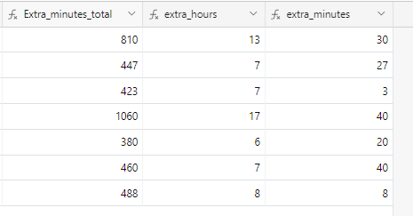

Extra_Minutes_Total gives you the total extra time in minutes:
(sunday_extra_hours * 60) + sunday_extra_minutes + (holiday_extra_hours * 60) + holiday_extra_minutes
Extra_Hours gives the total number of hours from the total of minutes:
ROUNDDOWN((Extra_minutes_total / 60),0)
Extra_minutes completes extra_hours by giving your remaining minutes:
 MOD(Extra_minutes_total,60)
Of course, you could factorise these 3 fields into one, but I find it harder to follow and I do not see the advantage.
If you need to separate extra time due to sundays and extra time due to holidays, you would need to compute the total of minutes for each case and apply the "extra_hours" and "extra_minutes" formulas to each total.
