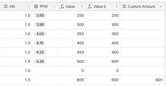

This shows both versions outputting the same thing. {Value} is the version using SWITCH(), and {Value 2} is the one that uses math. I wasn’t sure what to do for the {kW} field, so I just left it at 1 so you could see the raw output.

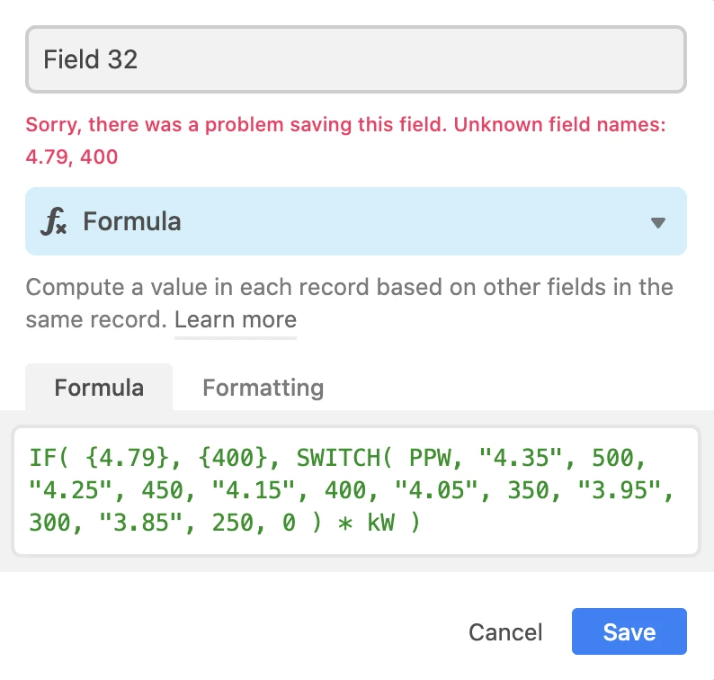

You guys are so incredibly smart! I’m just learning how to do formulas, and pretty much brand new to Airtable. Everything I’ve done thus far is VERY basic. So forgive me for asking a dumb question, but if I just copy paste your formula:

What am I inputting for the {Custom Amount} When I try to write down the custom commission, I get an error. And why are there two {Custom Amount}? Here’s the image of the error I get
When I do IF(
{4.79},
{400},
SWITCH(
PPW,
“4.35”, 500,
“4.25”, 450,
“4.15”, 400,
“4.05”, 350,
“3.95”, 300,
“3.85”, 250,
0
) * kW
This is the error I get as well
I’m not even going to try this formula because I don’t understand it. Lol

The formula that I wrote should be left untouched when pasting it into the formula field. Per the comment from @ScottWorld earlier, {Custom Amount} is a reference to a new number field that you need to add. Look at the screenshot I shared. Whenever you want to override the programmed values internally, you put the total value that you want into that {Custom Amount} field. I manually entered “600” into that field on the last sample record, and that overrides the formula’s main calculation.
The start of the formula can be read like this: IF the {Custom Amount} field isn’t empty, use the value in {Custom Amount}. Otherwise run this formula.
Does that make it more clear?
