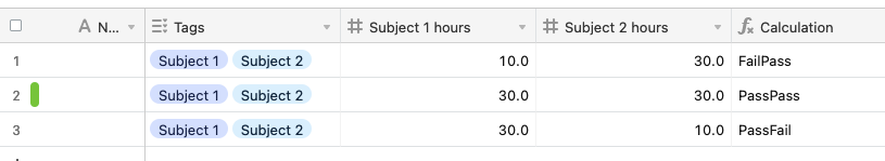

Hi Juan, I’d make a formula field to do the check for me and use that field for the conditioning:
And the formula used was:
  AND(
    FIND("Subject 1", Tags),
    {Subject 1 hours} >= 30
  "Pass",
  "Fail"
  AND(
    FIND("Subject 2", Tags),
    {Subject 2 hours} >= 30
  "Pass",
  "Fail"
  • October 6, 2022
  AND(
  "Pass",
  "Fail"
  AND(
  "Pass",
  "Fail"

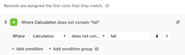

You see we have 9 subjects in total on the database, when expanding the formula you provided to reach all 9 subjects, obviously, there are 'Fail’s everywhere. Since not one student can take all 9 subjects, when we finally get to the conditioning for the color it is always going to find at least one ‘Fail’.
How can we work around this? Maybe eliminating the output of the word “Fail”?
Adam,
Thank you so much for your response!
Ah, so sorry, try this:
    {Subject 1 hours} >= 30,
    "Pass",
    "Fail"
    {Subject 2 hours} >= 30,
    "Pass",
    "Fail"
