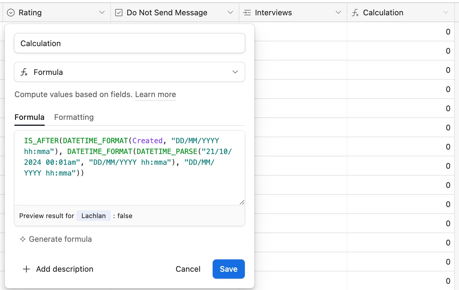

This is the formula I have been using but all the fields are showing up as 0 (false) when there are definitely some records created after the 21/10/2024. I had to use the date format with the date parse as it was automatically formatting the date in US format even though I have specified the format?
IS_AFTER(DATETIME_FORMAT(Created, "DD/MM/YYYY hh:mma"), DATETIME_FORMAT(DATETIME_PARSE("21/10/2024 00:01am", "DD/MM/YYYY hh:mma"), "DD/MM/YYYY hh:mma"))

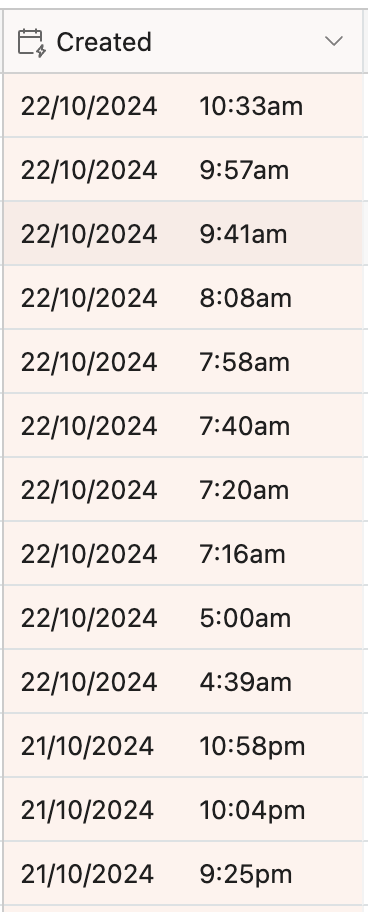

I also tried formatting both dates like in the photos below but still not getting the result I am after, any help would be much appreciated am i missing something simple or just over complicating the whole thing?

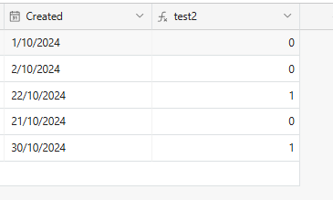

You do not need to change the date format within the formula, all you need to do is to input the compared date '21/10/2024' as '10/21/2024':
You should get the following result:
Regards,
Pascal

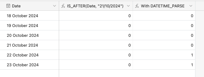

@Pascal_Gallais-   Hmm, I think there's some sort sort of interaction between the format of the Date field and the format we key in to the formula?  The formula didn't give provide the expected results, and I think it's because my Date field is set to "Friendly"
What do you think of us doing a single DATETIME_PARSE() at the end?
IS_AFTER( Date, DATETIME_PARSE( "21/10/2024", "DD/MM/YYYY" ) )

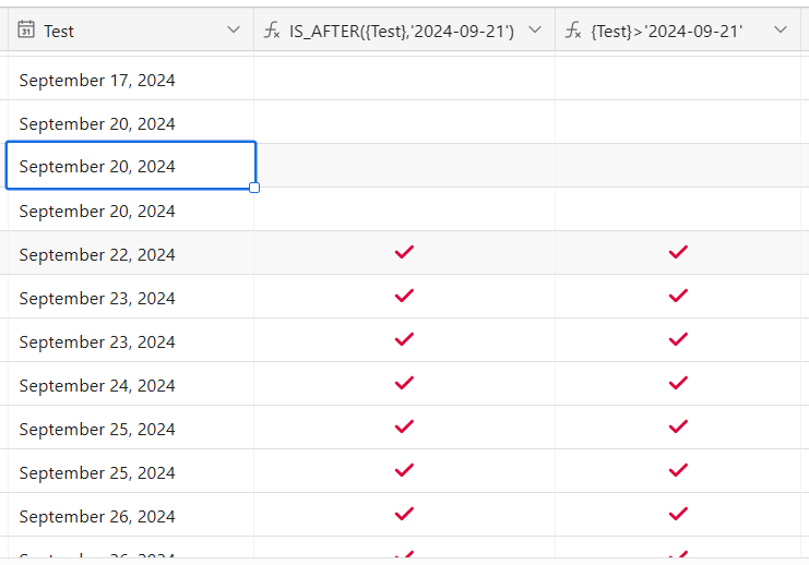

You can Use ISO format in formula to avoid mixing day and month.
It's the format with constant length (10 chars without time, '2024-10-27') and it can be sorted as string in correct order.
Anyway, it's better to use special date functions, than usual math operators. I mean, using 1st foirmula is OK. Using 2nd - OK, but check if possible, especially. 2024-09-21
