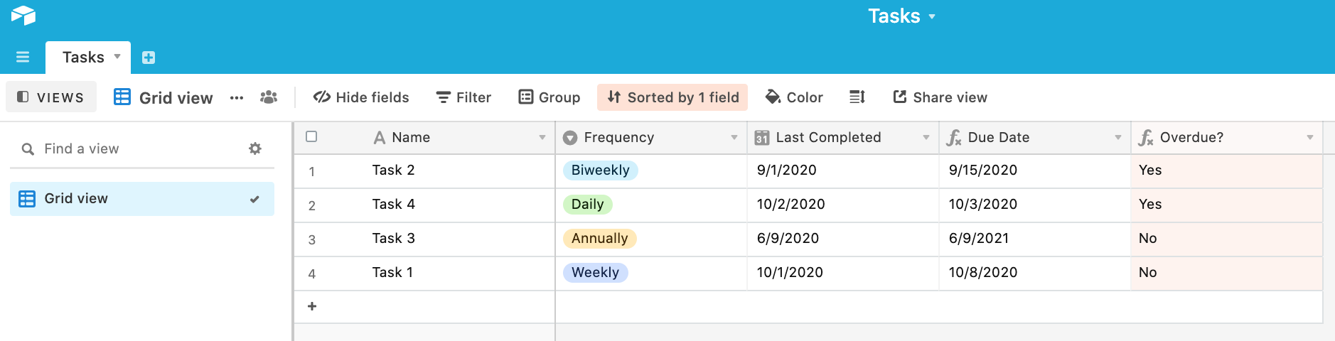

A formula field with a switch statement should work well for this. I created an example base with this formula that calculates a “due date” for each case:
SWITCH(
		Frequency,
			'Daily',DATEADD({Last Completed},1,'day'),
			'Weekly',DATEADD({Last Completed},1,'week'),
			'Biweekly',DATEADD({Last Completed},2,'week'),
			'Annually',DATEADD({Last Completed},1,'year')
“Frequency” is the field where you will select the time period of the task. Each case adds the correct time period. Then you can create a second field that compares the “due date” against the current day:
IF(TODAY()>{Due Date},"Yes","No")
Tasks Example Base

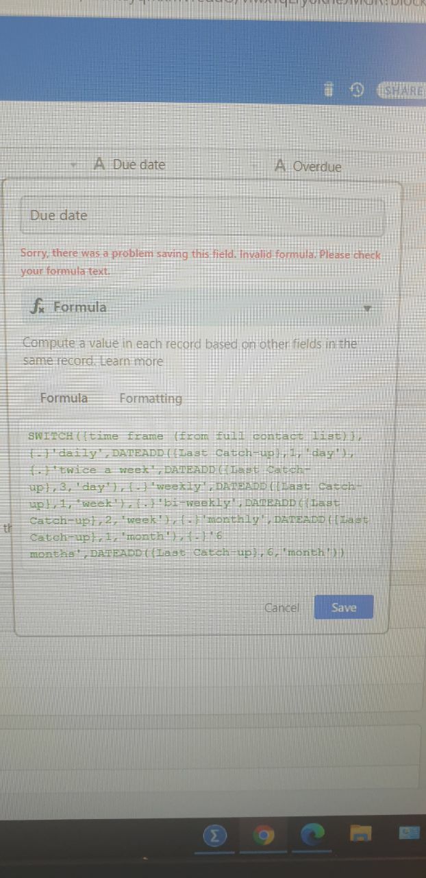

It doesn’t, i changed the names accordingly but it doesn’t work, it says something is wrong but i don’t see what
Julian_E_Post
Forum|alt.badge.img+14
Can you upload a screenshot of the code?
  • October 7, 2020
Julian_E_Post
It looks like the brackets with punctuation in front of each case may be your issue. What is the purpose of that? If you paste the code here, I’ll make a couple edits for you
  • October 7, 2020
SWITCH({time frame (from full contact list)},{.}‘daily’,DATEADD({Last Catch-up},1,‘day’),{.}‘twice a week’,DATEADD({Last Catch-up},3,‘day’),{.}‘weekly’,DATEADD({Last Catch-up},1,‘week’),{.}‘bi-weekly’,DATEADD({Last Catch-up},2,‘week’),{.}‘monthly’,DATEADD({Last Catch-up},1,‘month’),{.}‘6 months’,DATEADD({Last Catch-up},6,‘month’))
they don’t have a purpose it’s just what the computer gave me when i tried changing things.
thank you for your help.

Airtable is weird about quotation marks. Sometimes if you copy and paste from a different program, you end up with the directional quotations like in the above text, which it doesn’t like. Try redoing those - otherwise, your code looks great! In terms of empty cells, you could do something like this:
IF({Last Completed},IF(TODAY()>{Due Date},"Yes","No"),"")
The first IF() checks to see if there’s anything in “Last completed”, and if yes, it goes to the second IF(). You could also make a case in the Switch() statement to cover this so that it doesn’t show #ERROR when the cell is empty.
