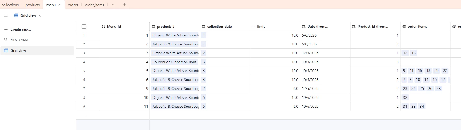

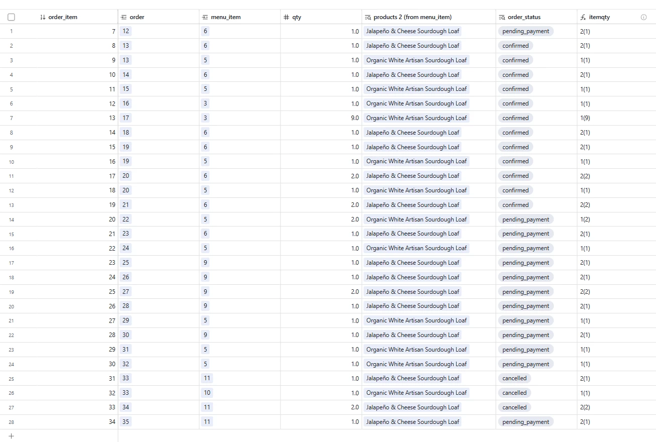

I think the issue might be that you’re looking up the linked record field instead of a name string. Compare your order_items screenshot, where “products 2(from menu items)” is a lookup field of a linked record, and not a text string like Adam’s screenshot where “Product Name (fro...” is a text string.
Try adding a lookup in your menu table, pointed at the product table, name field. It should create a string field instead of a linked record. Then lookup that field in your order_items table, and use that for your formula.

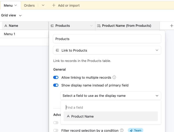

EDIT- I just recreated your bases from your screenshots and that’s definitely the proble, was able to recreate your error and adding those lookups fixed the problem. I think where you’re running into confusion too is that the linked record connection from products->menu is set to Show display name instead of primary field (set to Name). While that changes the display name the primary key is still the identifying field for the record.

Does this look right?
If so, I think you’ll just need to update your formula to be the following:
{products 2 (from menu_item)} & " (" & Qty & ")"
