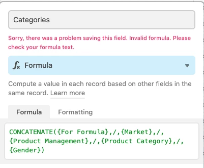

I have a formula "CONCATENATE({For Formula},{Market},{Product Management},{Product Category},{Gender})" but its output adds unwanted quote marks like so:
What I really want is to have it be separated by “/” but I’ve exhausted the time I have trying to fix that. How can I get this to output something with consistent quote marks - or comma separation - or preferably the /

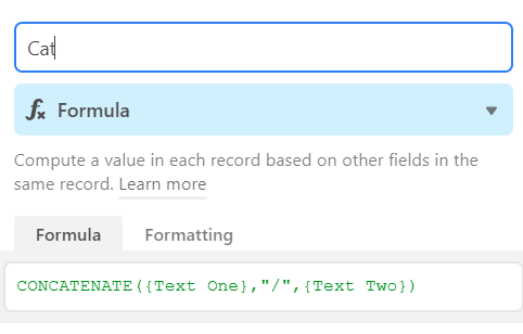

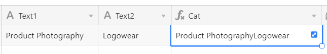

Hey Matt, the only way that I can make the double quotes appear is to have the field values inside double quotes.
Otherwise I get this…
And if I use this formula,
CONCATENATE(Text1,"/",Text2)
I get this
Did I miss something from your questions? I must have.

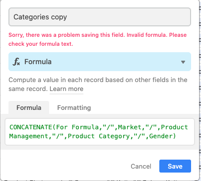

Thanks Augmented, yeah have tried that but the formula won’t run at all without the brackets or quote marks. Maybe due to the spaces in the Field names?
  • December 10, 2020

No, have tried every version with and without so maybe its not syntax related?

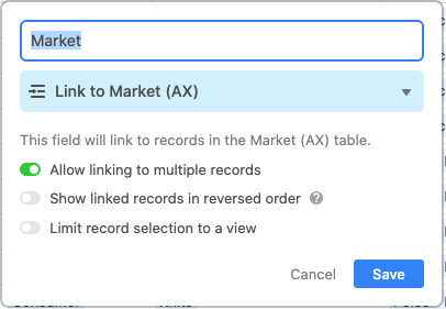

Regarding the extraneous quotes, what type of fields are these? Something tells me that the field type will provide a clue to the quotes (and the spaces inside the quotes). My gut says that there are some linked records and/or lookup/rollup fields in the mix somewhere.

Thanks Justin, the fields are links to tables that are all set up the same way.

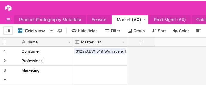

Thanks for the update. When referencing a link field, Airtable will sometimes wrap the names of the linked records in quotes, but that usually only happens when the primary field in the linked record contains commas. My only thought now is that there may be some invisible characters in those primary field names that Airtable is hiding when displaying the field, but they might show up if you edit the field, and it might be doing the quote-wrapping treatment as a result. As a test, double-click to edit that “Consumer” name to check for anything before or after the word itself. In fact, just retype “Consumer” manually to replace it, then see if you still get the quotes around it in your formula output.
