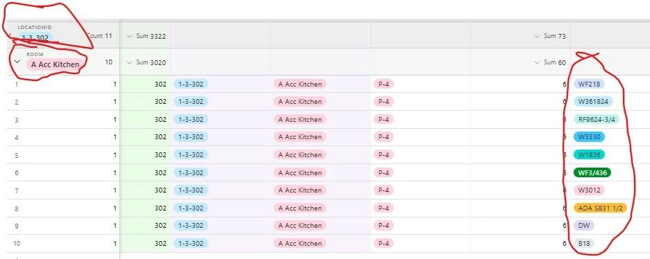

Hello:
New to Airtable and new to the forum here...

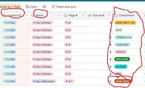

Looking for a solution to combine records in my field {Component], for every change in records in my fields {Location ID} and {Room}.  For example, in the attached image I would want to combine WF218, W361824, RF9624 3/4, W3330, and so on to B18, in a new field.  This is to correspond with {Location ID} 1-3-302 and with {Room} A Acc Kitchen.  For the next combined field, the result would be ADA SB30, for location 1-3-302 and room A Acc Bathroom.  I would like to accomplish with a formula, but I understand I may need to create a new linked table.
I am attaching 2 views; one is grouped and one is a straight view, for clarity.  Thanks so much!!

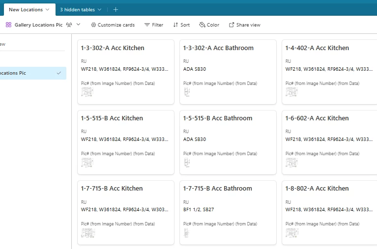

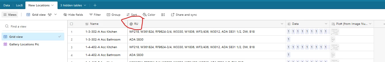

What I ended up doing was concatenating the location code and the room name together, and then created another table to link the new field to.  Then, I was able to create a roll up field for the components.  It worked great, putting all of the components for the particular location and room combination into one cell.
Then, I was able to create a gallery view, ideally to create labels, which will show the location and room, the drawing for the build-out, and the components all listed in the same label.  See screenshots.  Thanks again!!!

Sorry, I was looking to combine Components all in one cell, as changes occur in Location and in Room.  I was advised to create a linked table, and then create a roll-up field based on a new field, which would combine both Location and Room.  But, I did not have any success with that, either.  Only one component shows up, not all of them.  Thanks for your response.

In the 'Data' table, I want to rollup all {Component}, for each change in the {Combine Location}, in the 'Loc2' table.  The issue I have is that it is not doing this automatically.  I have to add new records to {CombLoc} manually, to get the {Components Rollup} to complete itself.  I'm not sure why it does not automatically add records to the 'Loc2' table.  Any help is greatly appreciated!  Thank you.

Adam, sorry for the delay.  I have been super busy!  Thanks so much for the offer of help I really appreciate that.
