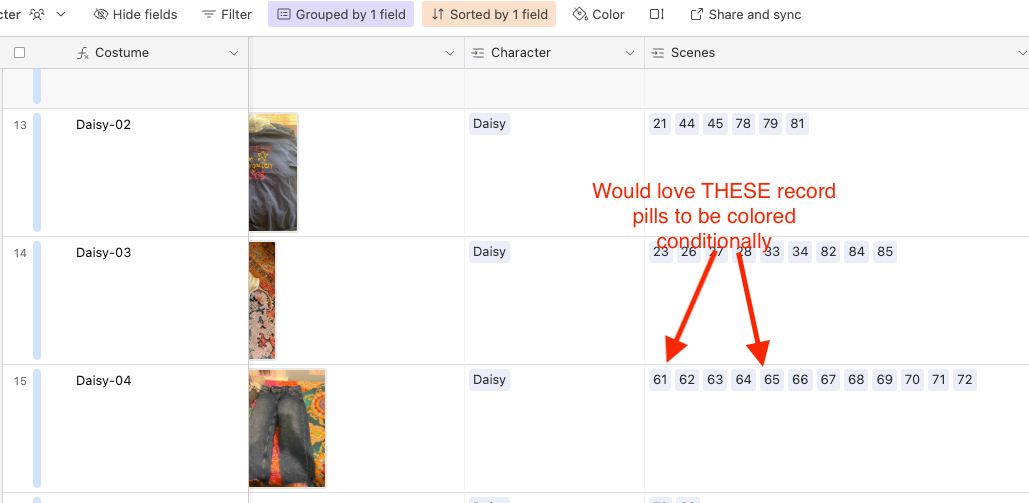

Conditional Coloring for the Record "pills" in a lookup field
Working on costuming for a film - have 4 main tables of Actors, Costumes, Scenes, and Characters.
There's a lot of table to table referencing going on w/ lookups...
But one thing I would LOVE to be able to do:
When looking at the COSTUMES table (characters have multiple costumes) - there is a lookup field that shows what SCENES that costume is used in.  (Scenes are described by a number).
In the SCENES table - I have a check mark field to keep track of what scene is wrapped (already shot)
Back in the COSTUMES table, the scenes a costume is used in all show up as a list of numbers in little grey pill boxes. I'd LOVE it if the color of those pill boxes could be colored differently if they have a checkmark in the "wrapped" field in the scenes table.
I created a conditional coloring of records in that SCENES table... but alas, it does not translate that record color over to the pills in the lookup field in the COSTUMES table.
 This image is from the COSTUMES table - pointing at a lookup field referencing the SCENES table
Any ideas??

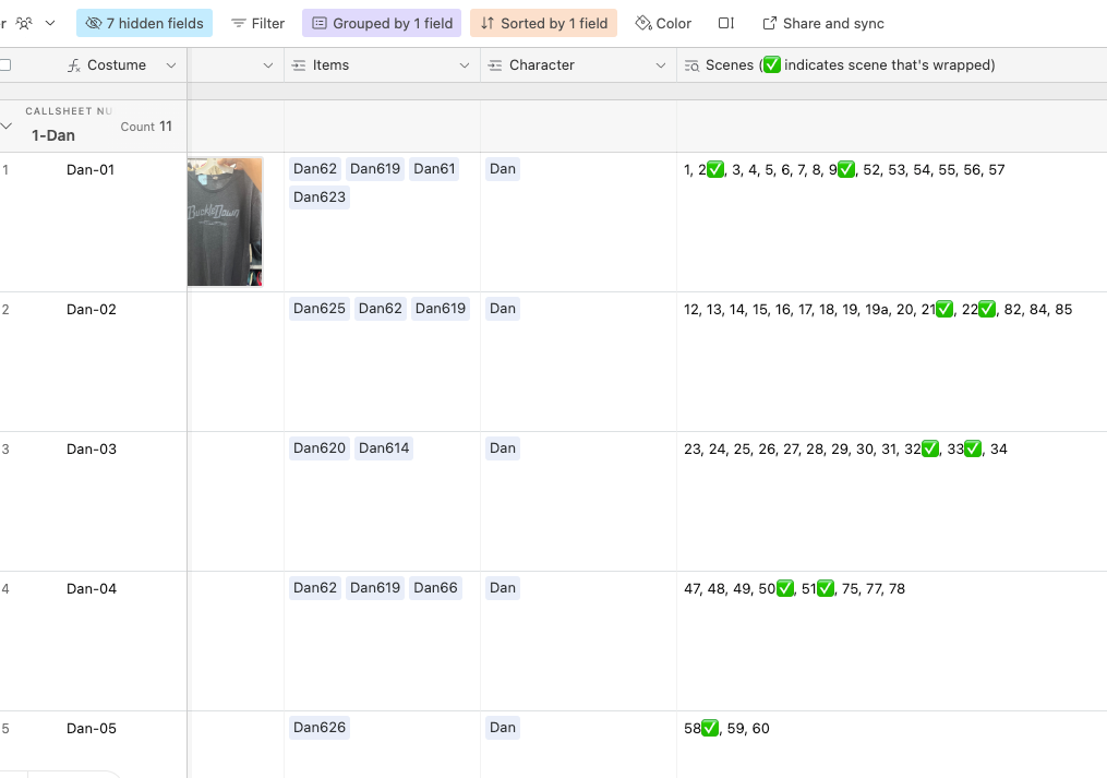

OK, you inspired me.
I ditched the analog version... and made a formula field in the SCENES table that references the primary field (Scene) and the "Wrapped" field - and used an emoji checkmark:
F(x) =
IF(Wrapped=FALSE(), Scene, Scene & "✅")
Then just did a simple lookup of that field in the COSTUMES table.
I sure wish you could format text (color, or even just bold) in a formula! But this works at a glance.
Thanks for sparking the idea! 
