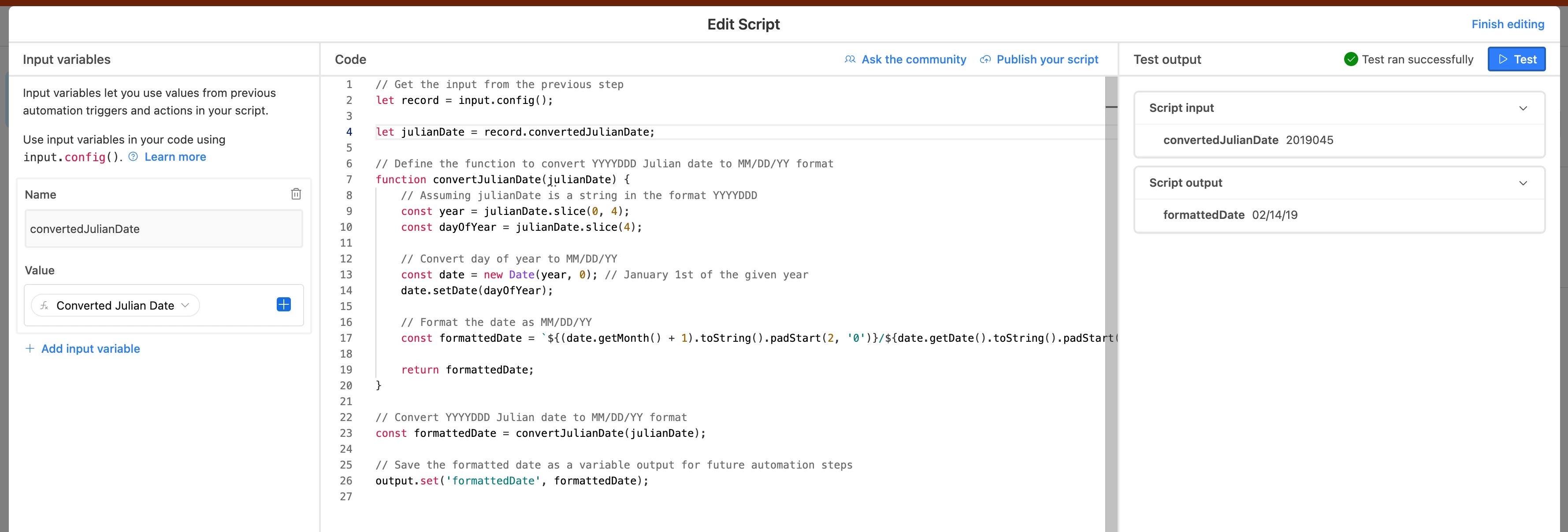

  • Jan 6, 2024 4:27 PM UTC
Probably a little late to this response, but you should be able to do this with an Airtable Automation + Script block.  I used ChatGPT to help write this script. Here is a video showing how I've used ChatGPT to help with these scripts.
Here is that code. Make sure the Input Variable name in your setup is convertedJulianDate.
// Get the input from the previous step let record = input.config(); let julianDate = record.convertedJulianDate; // Define the function to convert YYYYDDD Julian date to MM/DD/YY format function convertJulianDate(julianDate) { // Assuming julianDate is a string in the format YYYYDDD const year = julianDate.slice(0, 4); const dayOfYear = julianDate.slice(4); // Convert day of year to MM/DD/YY const date = new Date(year, 0); // January 1st of the given year date.setDate(dayOfYear); // Format the date as MM/DD/YY const formattedDate = `${(date.getMonth() + 1).toString().padStart(2, '0')}/${date.getDate().toString().padStart(2, '0')}/${year.slice(2)}`; return formattedDate; } // Convert YYYYDDD Julian date to MM/DD/YY format const formattedDate = convertJulianDate(julianDate); // Save the formatted date as a variable output for future automation steps output.set('formattedDate', formattedDate);
