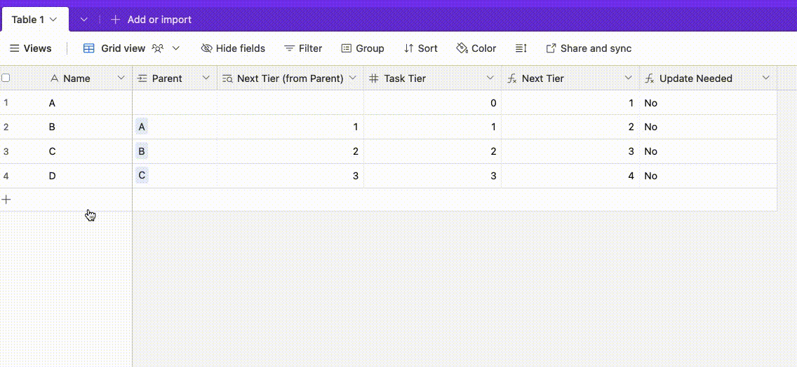

Try:
1. Make a formula field that helps you calculate the tier of the next child task ("Next Tier" in the gif below)
2. Create a lookup field to display the value of the field from step 1 ("Next Tier (From Parent)")
3. Create a formula field that'll check whether "Next Tier" value matches "Next Tier (From Parent)"
4. Create an automation that'll update the triggering record when the formula field from step 3 indicates that the values don't match
Should do what you want I think!

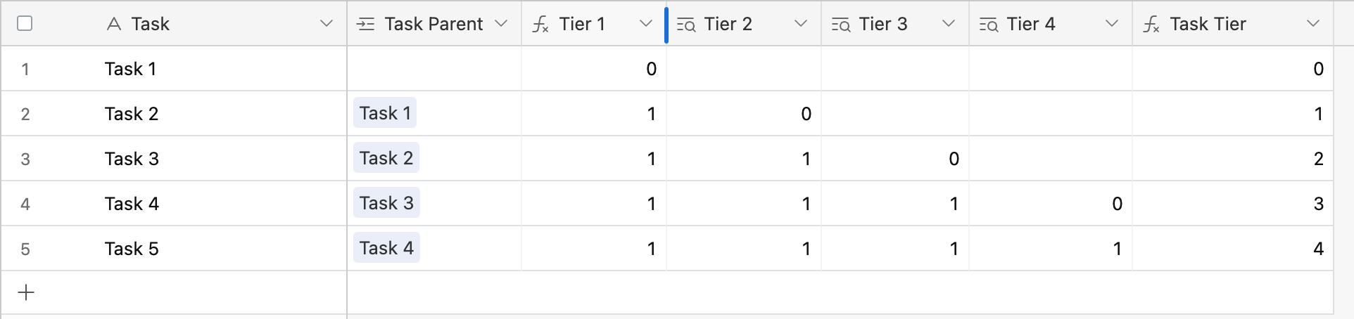

The platform does not natively support recursive relationships or direct querying of a hierarchy's depth in a straightforward manner. However, you can achieve your goal by using a combination of linked records and formula field to track the hierarchy level ("Task Tier") of each task based on its relationship to a parent task.
Tier 1 - Formula that checks if there is a parent, if there is it return 1, otherwise, 0.
Tier 2 - Lookup of Tier 1
Tier 3 - Lookup of Tier 2
Tier X - Lookup of Tier X-1
Task Tier - sum of Tier 1 + Tier 2 + Tier 3 .... + Tier X
It is not elegant but this is the only way I can think of bypassing Airtable's data structure limitations.
