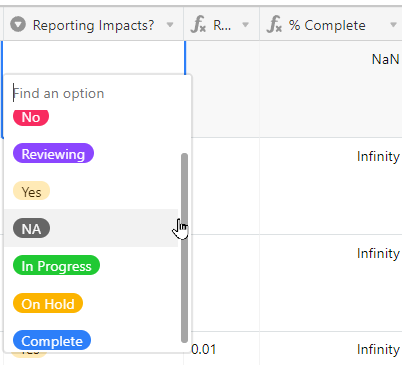

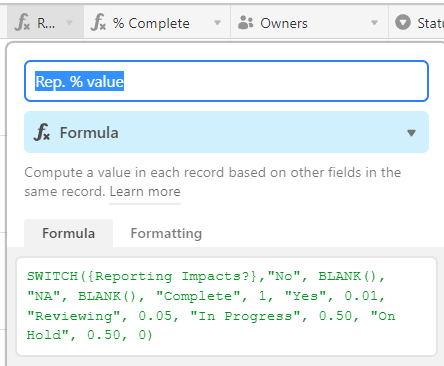

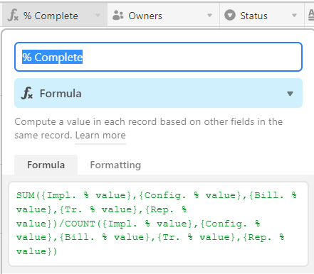

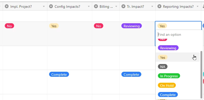

Can you post a screenshot showing all the relevant input and formula fields?
Joel_Andrews1
Forum|alt.badge.img+14
Here are the options for each of the 5 team fields:
Here’s the SWITCH formula used for each team:
And here’s the % Complete formula:
  • January 9, 2022

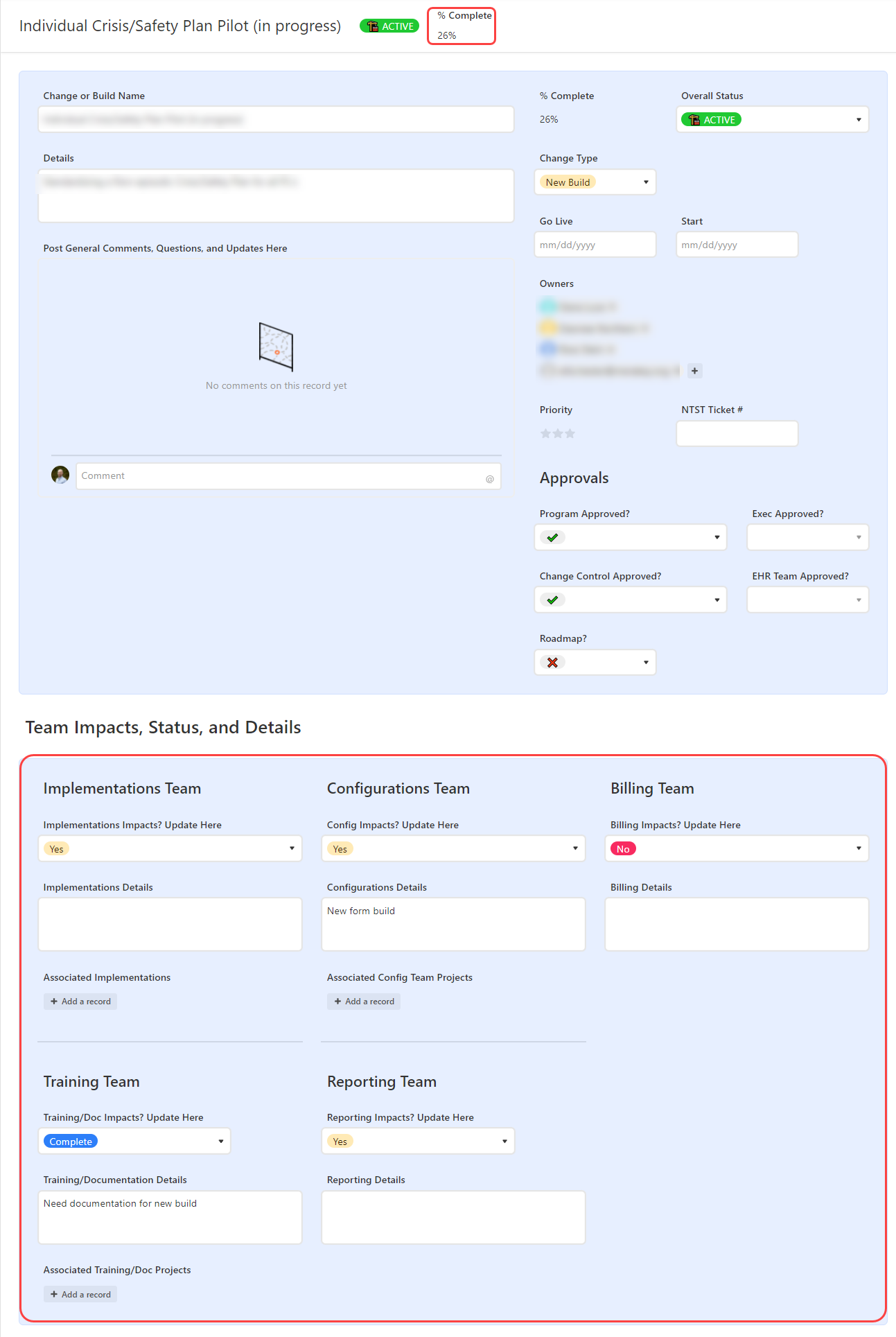

Joel_Andrews1
As a bonus for anyone that’s interested in replicating, here’s a shot from the interface I built for this:
