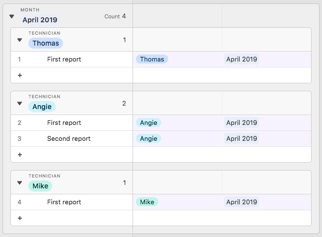

What about grouping? Group by the month links, then group by technician.
If you need to actually end up with data in a field that you can put into a report of some kind, this won’t get you there, but you can see the report-per-technician tally right next to their name.
