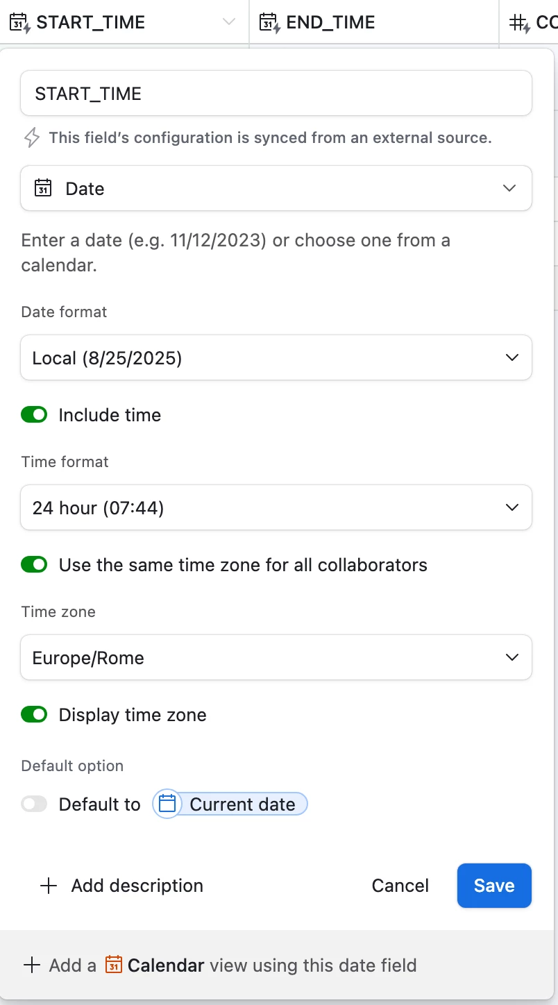

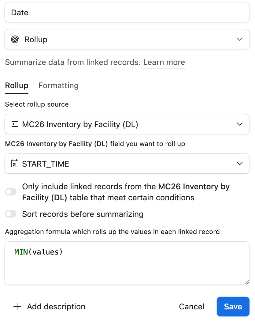

All fields are operating as expected in the original base.  I have synced the table to another base and all fields operate successfully except for the date (rollup) field.  The date field is not syncing properly.  Below is how the rollup field is set-up in the original base.
I have confirmed the date formatting in all bases are identical.
Any ideas on why this might be happening? Thanks!
Rollup field in the original base (successful)
Original Date Field

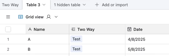

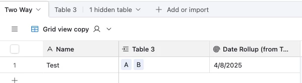

Hmm as a datapoint I just tried this and it seemed to work fine, screenshots below.  Any chance you could provide some screenshots of your tables?  If you could DM me links to your base I could help you take a look at it too
Synced table:

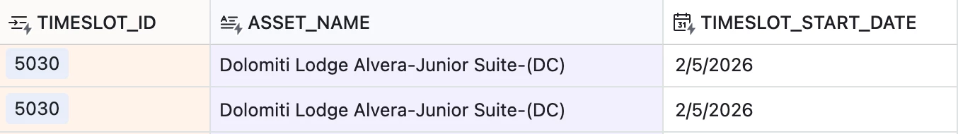

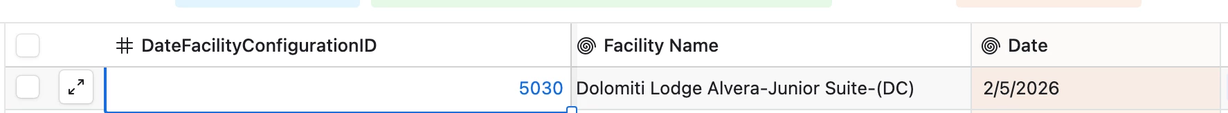

In the originating base, the date field is "start time" field using a rollup of min values is showing a different value  (usually one day off) in other synced tables.
Table A - returns 2/5/26 (correct)
Rolls up into Table B (same base) - returns 2/5/26 (correct)
Synced to Table C (separate base) - returns 2/4/2026 (incorrect)

Hm yeah, I have that exact same setup.  If you display the timezone on all of the fields, they’re all displaying the same timezone as well I take it?
  • August 26, 2025
Correct - confirmed they all have the same exact date format. I appreciate you putting eyes on it ​@TheTimeSavingCo!
