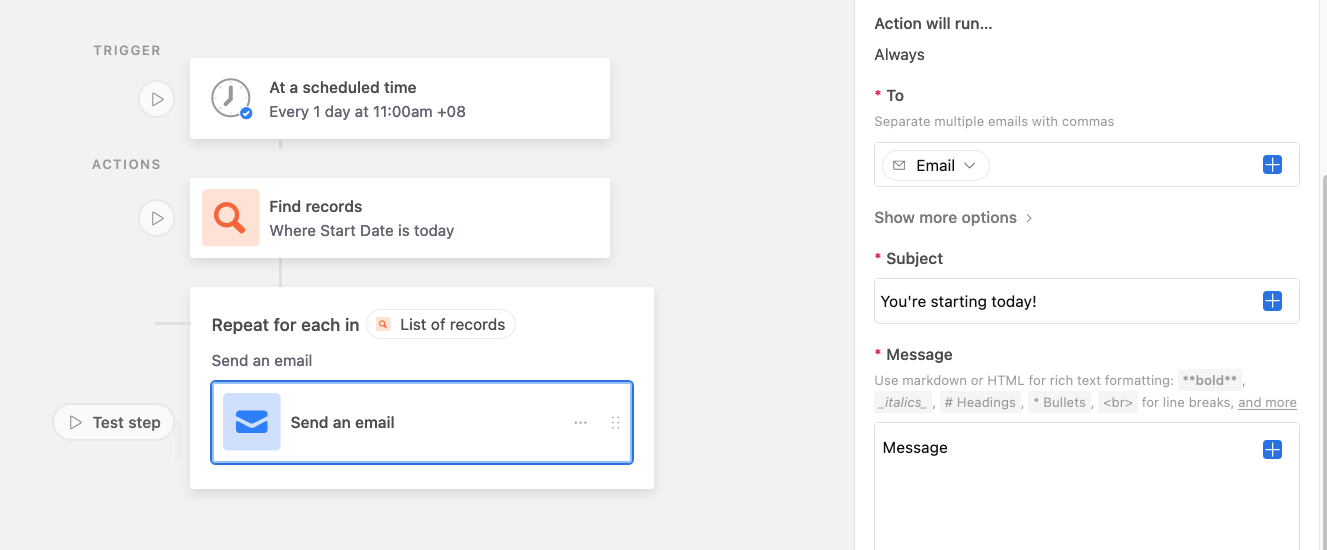

If I were you, I would try the following:
1. Create an automation that triggers every day at 11am
2. "Find Records" action that looks for all records where the date is today
3. Repeating group with a "Send email" action
This would thus send an email to each person whose start date is set to today
Here's a link to a base with this set up
Hi Adam,
The solution you proposed worked very well. That’s great and thank you very much.
