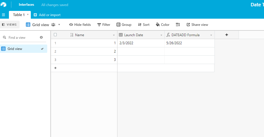

Hello @S_Pacheco-Williams!
Here you go!
    {LAUNCH DATE},
    DATETIME_FORMAT(
        DATEADD(
            {LAUNCH DATE}, 16, 'weeks'
        ), 'l'
Here, you’ll want to use the DATETIME_FORMAT function to format the raw date/time string that it was spitting out at you.
Here’s what it looks like from my end.
Please let me know if you have any questions about this!
