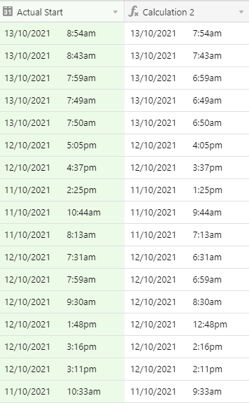

Hi Everyone,
I’ve come across an issue where I can’t seem to get the date to print the correct time within a formula.
Please see example, I’ve stripped it down ot its bare bones.
On the left is a date (and the time is correct). On the right is that date reprinted as a function. It appears to be an hour off.

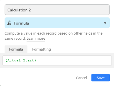

This is the formula for the function (simply reprinting the date):

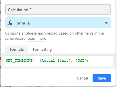

It also gives the same result (incorrect) if I set the time to my time zone, which is GMT.

Have you checked the time zone setting for both the original field and the formula field? The settings for both fields must match.
Is your local time one hour off from GMT?

You should not need to “find” your time zone. Airtable uses the timezone of your local computer/browser.
If you are using a formula field with DATETIME_FORMAT() and SET_TIMEZONE(), the list of timezones is documented here. However, it seems like you are not using DATETIME_FORMAT(), and there is no need to use SET_TIMEZONE() on its own.

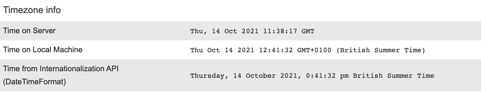

If you go to this browser time zone test page. what time zone does it say you have?
In your first attempt, you probably had the default formatting options for each field, and they are different time zones. The default for an editable date/time field is local time. The default for a formula field is GMT.
  • October 14, 2021
It shows a discrepency actually. Maybe this is the cause of the problem?
  • October 14, 2021
The screen capture shows that your browser knows your are in BST, which is an hour later than GMT. This matches what you were first seeing in and my suspicion that you had the default time zone settings for the fields.
By default, the editable date/time was in local tile (BST) and by default the formula field was in GMT, an hour earlier. If you set the format options of both fields to use local time, everything should look right.
