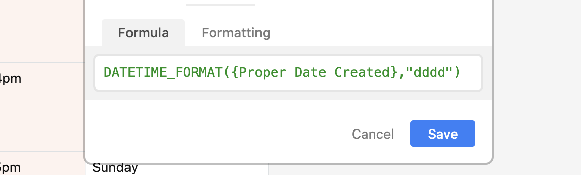

Hi. I’m trying to use DATETIME_Format() inside of a formula field to display the day in which an order was placed.

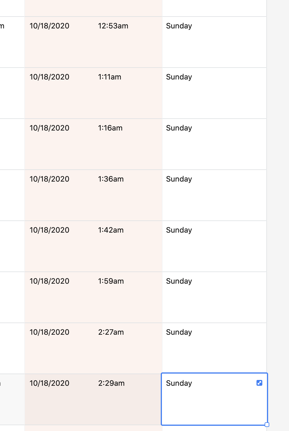

These are the dates of the orders. For reference, the 18th took place on a Sunday.
The formula block is a very simple DATE_FORMAT() function, showing the day. However, it seems as if the date format is incorrect and is defaulting to GMT time (adding 4 hours to the time fields, causing the time to roll over to the next day). I don’t know how to fix this, and I can’t change it because under formatting it says:
Can someone please help?! Thanks

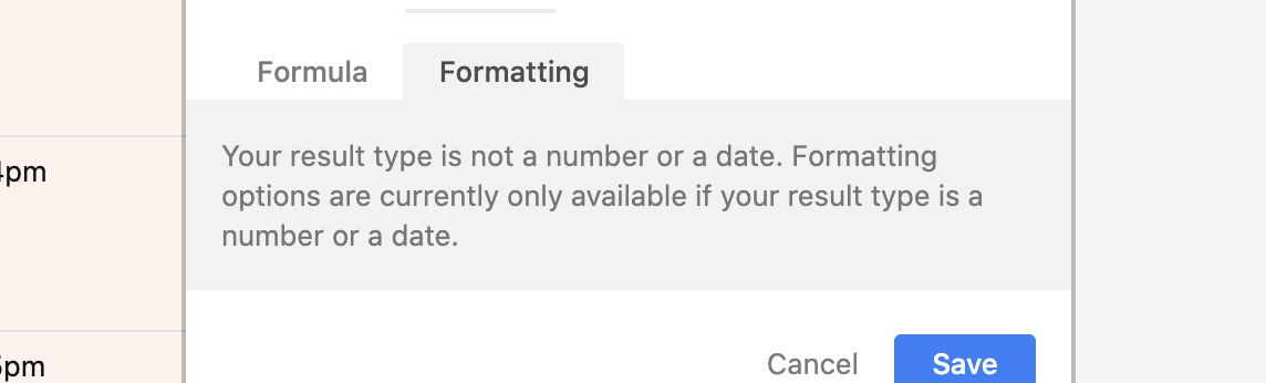

When you use DATETIME_FORMAT, the result is a string, not a date object. That is why you cannot set formatting for the formula.
Since you want to display only the day of the week, you need to show a string, not a date object.

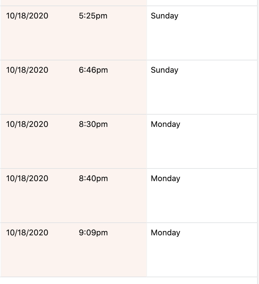

Here’s a follow-up question: Since I’m trying to create a formula that will display the proper day an order was placed (ex. an order placed on Saturday night at 3am will show as ‘Sunday’, but needs to be adjusted in the formula to show Saturday). I’m trying to use the IS_BEFORE() or IS_AFTER() logic to decide if a time is after 12am and before 5am, which on TRUE would require using DATEADD() to subtract 1 day from the date.
IF(AND(IS_AFTER({Proper Date Created},"12:00am"),IS_BEFORE({Proper Date Created},"5:00am")), DATETIME_FORMAT(DATEADD(SET_TIMEZONE({Proper Date Created}, 'America/New_York'),-1,"day"), 'dddd'),DATETIME_FORMAT(SET_TIMEZONE({Proper Date Created}, 'America/New_York'), 'dddd'))
Here’s the current formula I’m using, but it doesn’t seem to be working. Otherwise the values in the photo above should be reading ‘Saturday’, not ‘Sunday’ - correct?
Thanks again for your help!

The parameters passed to IS_AFTER() and IS_BEFORE() must both be datetime objects. Wrapping quotes around a time doesn’t create a valid date for comparison, which is why “12:00am” and “5:00am” aren’t working.
I suggest using the HOUR() function to get the time of the {Proper Date Created} field for comparison. Be aware, though, that you’ll need to also account for the difference between GMT and your local time when doing this. For example, I’m in the Pacific timezone. If I want to see if a time is after midnight (which is 0 when returned from the HOUR() function; and BTW, all hours returned are based on 24-hour time), I have to compare against an HOUR() value of 7 because my timezone is GMT -7. In your case, where you want to see if the hour is between midnight and 5am, and you’re in the Eastern timezone (GMT -4), the first part of that formula would look like this:
IF(AND(HOUR({Proper Date Created}) >= 4, HOUR({Proper Date Created}) <= 9), ...
On another note, the SET_TIMEZONE() function only works when used directly inside of DATETIME_FORMAT(). Your first instance is nested inside DATEADD(), which won’t work. The nesting order need to be shifted so that DATEADD() is inside SET_TIMEZONE(). In short: add the date, then set the timezone, then format.
With all that in mind, I think this formula should work:
DATETIME_FORMAT(SET_TIMEZONE(DATEADD({Proper Date Created}, -1, "day"),
'America/New_York'), 'dddd'), DATETIME_FORMAT(SET_TIMEZONE({Proper Date Created},
