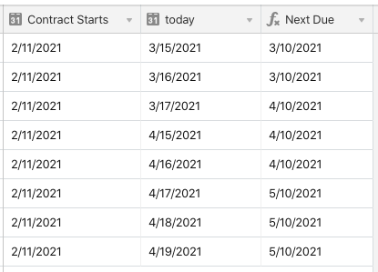

Here’s a look at my test data (replacing TODAY() with reference to the {today} field).
Thank you, Much appreciated. Works perfectly!!
