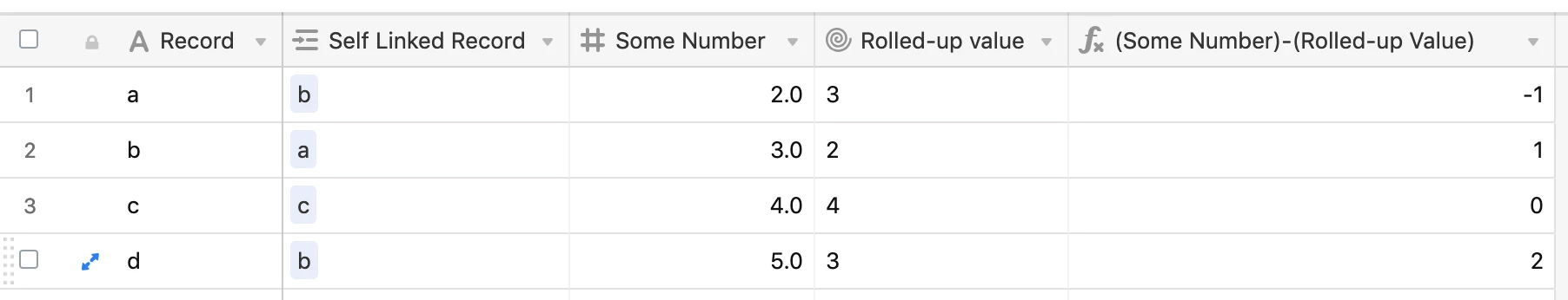

Directly like a spreadsheet: no.
Workaround: Airtable is much more a relational database than a spreadsheet, as such one row in a table does not inherently ‘know’ that any other row exists. The address of a row (record) does not necessarily have a common reference structure like record 1,2,3,… so you can’t get a result from 2 records without explicitly telling a record to pull data from another record.
A way to do this would be to create a link between 2 rows of interest, as follows:
  • Create a linked record field, referring to the same table itself, and the field with the number you want to work with in that field.
  • create a rollup field, referring to the other record of interest
  • Create a formula field to subtract the value existing in the row from the rolled up value
I tested the method I’m suggesting to make sure there were no circular reference issues.
