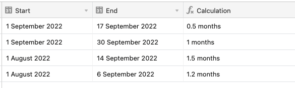

Hi @Allan_Mayes, try this out:
ROUND(
  DATETIME_DIFF({End}, {Start}, 'days') / 30,
  1
) & " months"
It assumes every month is 30 days, but eh, we’re rounding to one decimal point anyway so I figured it’s fine

Thanks @Adam_TheTimeSavingCo it works great! Such a simple idea that I had completely overlooked.
