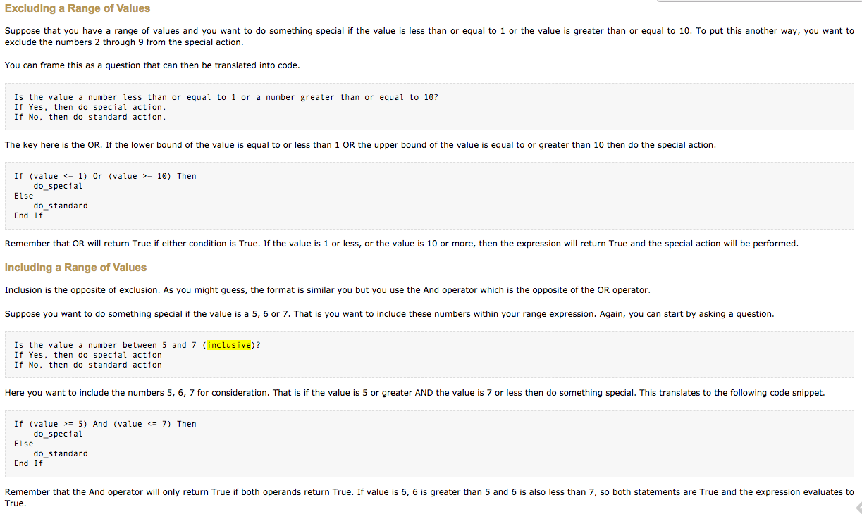

Yes, my confusion came from the use of AND and OR operators, but at the end you are right.
Hope this text help to clarify if somebody who read the post is confused about including and excluding range of values.
