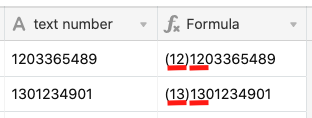

The other issue is with the MID function. The second argument passed to MID() is a number that tells Airtable where to begin grabbing the characters. By starting that latter part at character 1, you’re going back to the beginning of the string. This leaves you with the first two characters inside parentheses, and the full string—including those same first two characters again—after the parentheses. It looks like this (notice the repeating numbers underlined in red):
If you want to not repeat those characters, change the 1 in the MID() function to a 3.

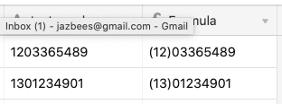

In the end, the corrected formula looks like this, followed by its output:
IF({text number}, "(" & LEFT({text number}, 2) & ")" & MID({text number}, 3, 50))
