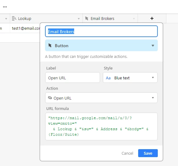

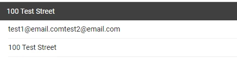

Thanks for taking the time to chime in. The problem I’m having is as follows:
Using the button tool, I am able to copy the email addresses from the Lookup column displaying them and have them inserted into the “to” section of the email - but even though they have commas in Airtable, they are being spit out in the to section without a separator (ie. john@test.comjane@test.com)
I’ve tried using both the Lookup and Rollup columns in this formula (pulling from the same property on the other table) and both spit out the emails without a separator between them.
I’ve included images of the the formula and what the final output looks like:
Any thoughts for a workaround?
Thanks,
Noah

With a rollup field, use the aggregation formula: ARRAYJOIN(values, ",") . That will force a comma between the addresses. The same would work with a lookup field, but this function would need to be part of the button field formula, to process the array from the lookup field.
That aside, I see that you’re trying to insert this into a URL to Gmail. That adds a whole new wrinkle into the process, one which you should’ve mentioned earlier. :winking_face: I thought you were building a standard “mailto” link, not a website URL. With that in mind, you’ll also need to wrap the addresses in ENCODE_URL_COMPONENT() so that the non-alphanumeric symbols are properly encoded for the URL. The same will also need to be done for the other values passed to the URL.
If you use the lookup field shown in your screenshot, then your formula would look like this (broken up on several lines for clarity:
"https://mail.google.com/mail/u/0/?view=cm&to="
& ENCODE_URL_COMPONENT(ARRAYJOIN(Lookup, ","))
& "&su=" & ENCODE_URL_COMPONENT(Address)
& "&body=" & ENCODE_URL_COMPONENT({Floor/Suite})

@Justin_Barrett
This is super helpful - thank you so so much for clarifying in detail. For what it’s worth (and likely because I’m doing something wrong on my end), this button does not work when inserting the ARRAYJOIN function straight into the rollup column aggregation formula (button is greyed out and not clickable) but it works perfectly with the Lookup column (inserting ARRAYJOIN into the button’s URL formula).
The final question on this - I’ve tried using “\n” to skip lines in the & “&body=” section of the button URL but it doesn’t seem to be picking it up. Am I doing something wrong or does the button URL formula not accept line skips?
Thanks again for your continued help!
Noah
