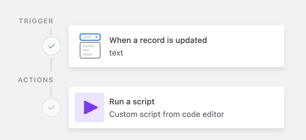

Alternatively, you could manybe setup an automation that watches a {text} field then runs a script, like below, which outputs to a {Formatted text} field.

Hi Dominic.  Thanks for your reply. Using an automation + script for something this simple sound like an overkill. Plus I don't want to be possibly hitting my API limits because of something which should be so basic.
