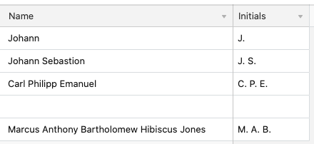

@Bill.French How did you know that I wouldn’t be able to resist this little puzzle, even though I am swamped with work?
Here is a base with the formula
Here is a form where you can test it out
Comments:
  • This formula can create initials for a maximum of three names, and there must be exactly one space between each name.
Comments:
  • A script could handle more than three names, multiple spaces, and other irregularities. However, a script has to be triggered by either a button or an automation.
Comments:

@Justin_Barrett Thank’s for testing out my demo.
Yes, your long test name didn’t parse the initials beyond the first three. In my comments in my original post, I explicitly stated that this particular formula only worked for three names, along with other limitations of formulas.
As for not sharing the formula (and thus not sharing the base), I am still working on balancing giving away formulas for free, versus my need for income.
