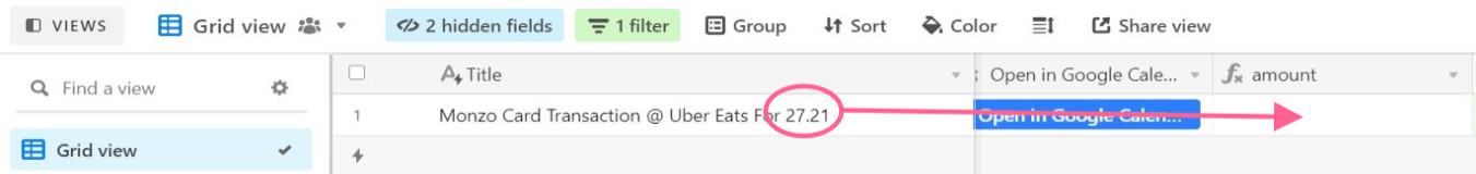

I’m trying to find a numerical value from the “Title” field and have it appear in the “amount” (e.g. 27.21)
I’ve used this formula from looking at a few post’s but it only copies the values before the decimal:
MID(
{Title},
FIND(
“For”,
{Title}
  • 6, 50
Another formula I found only copies the values before the decimal:
IF({Title}, VALUE(RIGHT({Title}, LEN({Title})- FIND(“0”,“1”,“2”,“3”,“4”,“5”,“6”,“7”,“8”,“9”, {Title}))), 0)
What formula do I need to get the full total which in this example is 27.21?

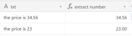

Check your “Formatting” tab right next to your “Formula” tab (it has the box where you enter the formula). You probably need to adjust it. Here is my formula working for both types.
