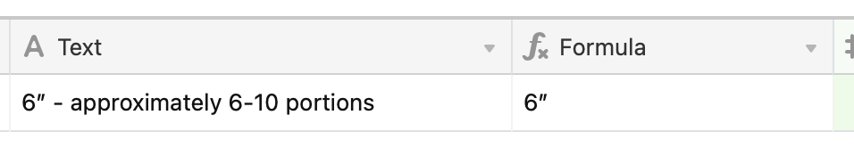

@Harry_Batten You wouldn’t need REGEX for that… you would just need to take all the characters to the left of the first space like this:
LEFT({Your text field},FIND(" ",{Your text field})-1)
Put that formula in the other table, and then just lookup that field in the first table.
Take a look at the screenshot below to see how this formula will extract what you need:
If you have any questions, let me know!

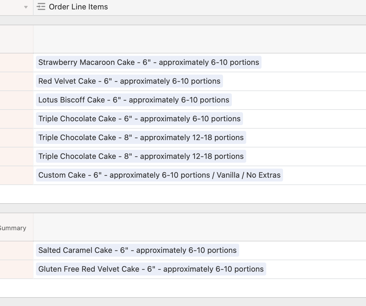

Is it possible to store the individual bits of information about each cake in separate fields and then use a formula field to create the primary field?
For example, you could store just the size 6 in a number field and then use a SWITCH formula field to indicate the number of portions.
That would really be better than extracting the number of inches using a REGEX. Also, in your screen capture, all of the cakes are 6". Are the only possibilities 6" or 8"? Will there ever be different sizes or cakes that don’t have a size? REGEX expressions are notoriously difficult and can be finicky if you don’t know all the possibilities.

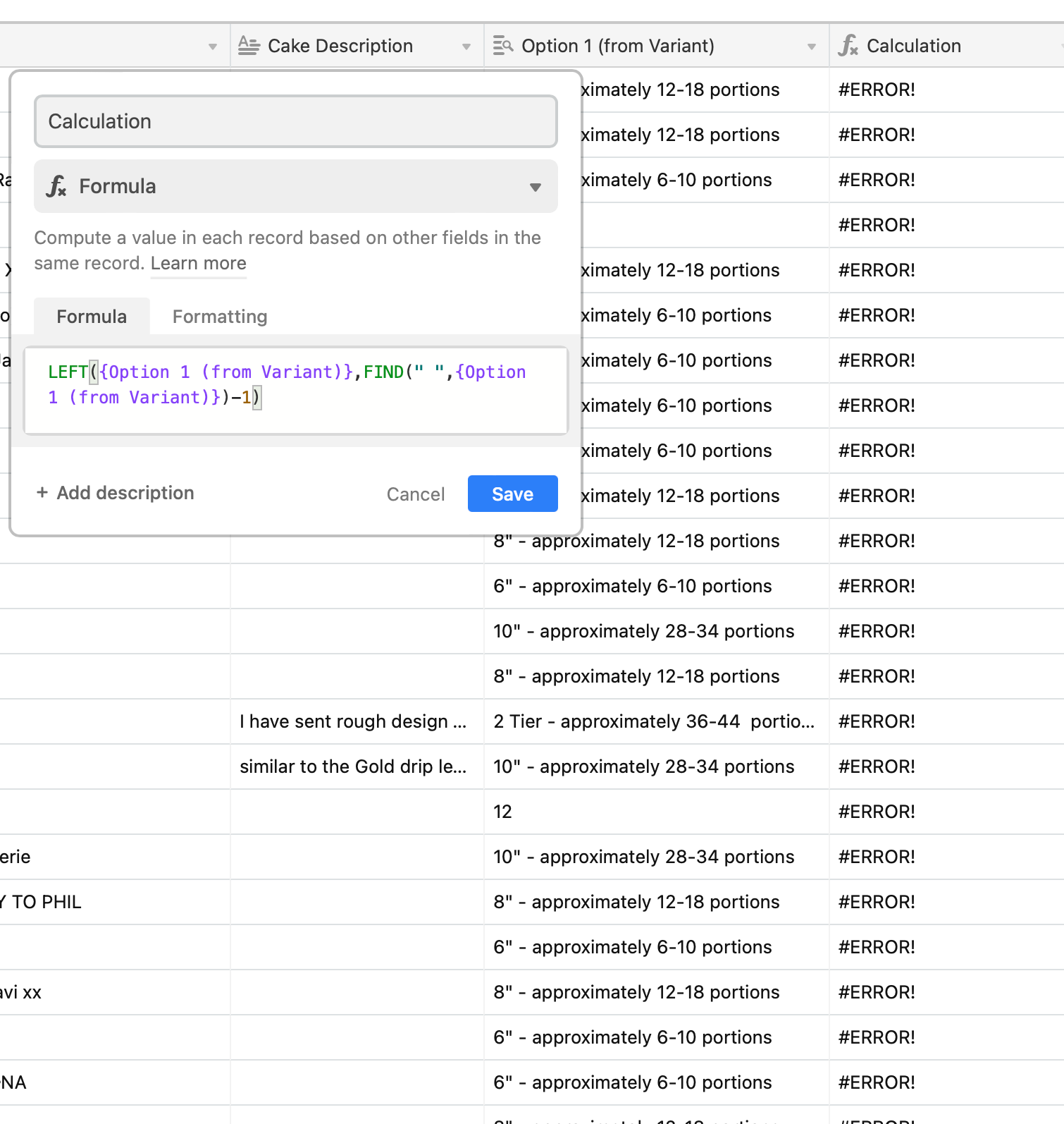

Thanks, I think i’m doing something wrong with it though as its giving me an error message.
I meant for you to do the formula from the other table, but if you’re doing it from this table, then you need to add &"" after each reference to the field.
Add it IMMEDIATELY AFTER the closing curly bracket for BOTH of your field references.
  • May 23, 2022

Also, this new screen shot shows more information and an inconsistent data format for the 12 option–it doesn’t have the inches specifier, probably doesn’t have a space, and doesn’t list number of portions. If there is no space, it will mess up the formula that looks for a space.
I still prefer a schema change to get the size in a field by itself, with a formula field to state the portions.
