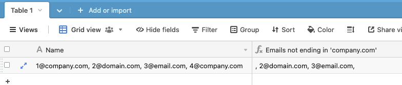

Yeap, and you can use the REGEX_REPLACE() formula to do what you’re looking for after you get the expression sorted like so:
Here’s the formula I used:
REGEX_REPLACE(Name, '[^,]@company.com', '')
I’m not entirely sure what I’m doing with regex and it’s pretty much magic to me, so apologies if it doesn’t work as intended. It’s got some leading and trailing comma issues, and those can be dealt with via some IF()s or more regex if needed I reckon

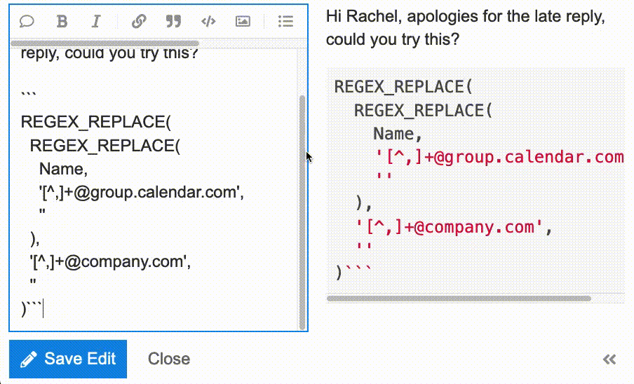

Hi Rachel, apologies for the late reply, could you try this?
REGEX_REPLACE(
  REGEX_REPLACE(
    Name,
    '[^,]+@group.calendar.com',
  '[^,]+@company.com',
Edited to fix backticks issue!
  • August 23, 2022
REGEX_REPLACE(
  REGEX_REPLACE(
    Name,
