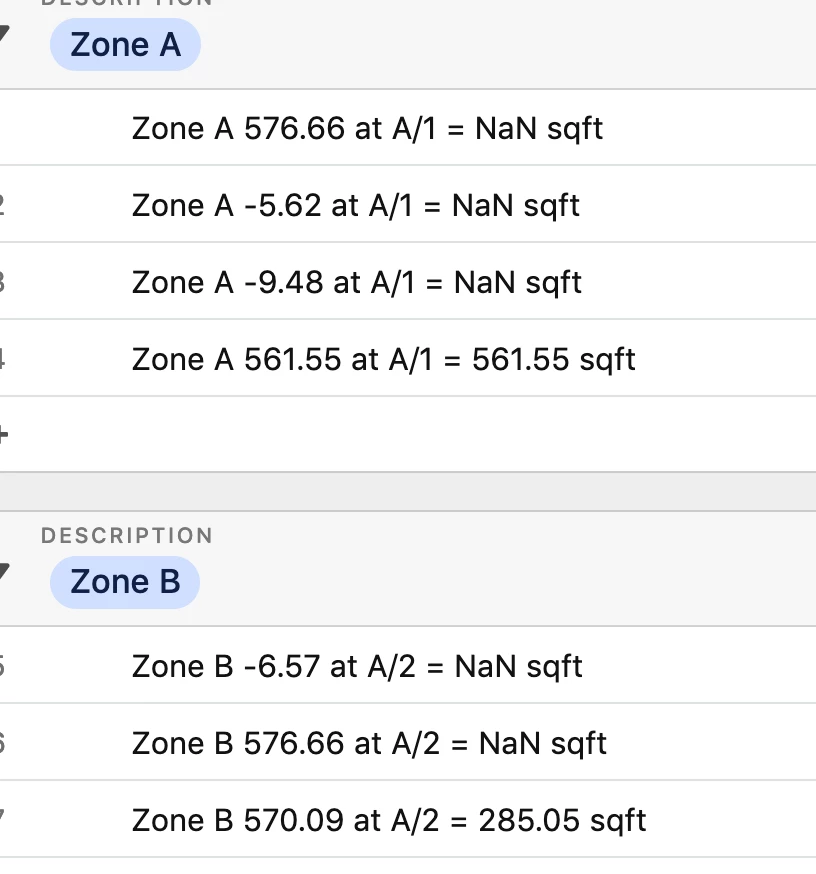

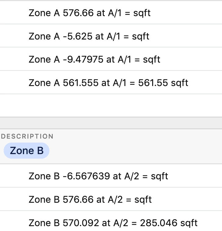

Incidentally the above formula works without any problem in most of the rows, as per the screeshots below:

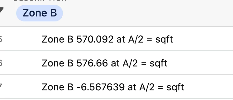

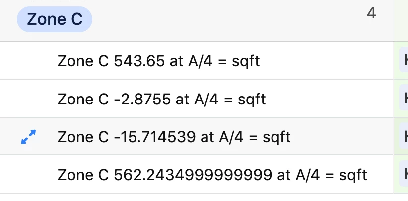

I am not trying as John B2 suggests 15000" to "9975" to make "150009975" but to display te text in the field 'description', its area in is the field for the area, the fraction for theat area (eg A/1 or A2/) that I have entered in the fraction field and the result which I ahave also entered in a sparat field, per this amended schreenshor:
