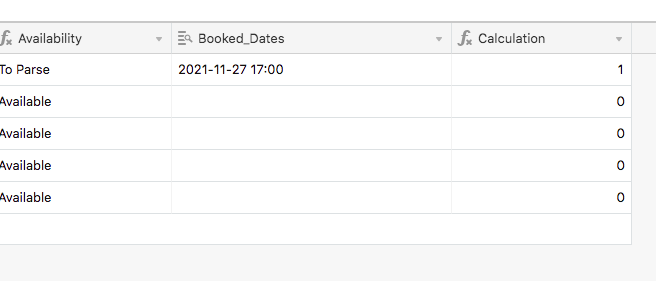

I’d like to make an API call with a Filter formula on a lookup field, which includes comme separated dates, see below :
As you can see, there is a simple calculation field that is : IS_BEFORE(TODAY(),Booked_Dates) that doesn’t seem to be very happy with the multiple item field on Line 1.

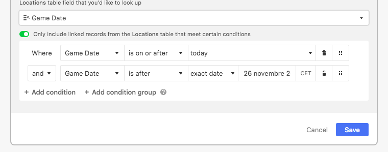

However, when I’m filtering lookup fields with conditions in Airtable it seems to work perfectly fine (don’t notice both conditions, only the second one):

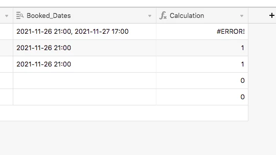

And the result :
So my question is : Is there a formula I can use to have the same behavior than Airtable’s lookup filter so I can make the appropriate API call in the FilterByformula query ? Or is there any workaround that one of you might suggest ?

The core problem is that you’re pulling dates through using a lookup field. Lookup fields often return different data structures depending on the number of linked records and the type of data being returned. For a detailed breakdown, I built a table to keep track of the differences:
Long story short, the lookup field is returning a single datetime when there’s only one linked record. Once there are two linked records, then it most often starts to return an array. While Airtable does have a few array functions, they’re fairly limited, and none of them allow for processing the individual items inside the array.
Unfortunately not.
What table is being referenced by that {Booked_Dates} lookup field? Add a field there that uses the IS_BEFORE(TODAY(), {Date field here} formula, which will output either a 1 or 0. Then turn your existing {Calculation} field shown above into a rollup to pull in and process those formula field values.
The problem then becomes the aggregation formula to use in that rollup field. Your description above doesn’t make it clear if you want that formula to output a 1 if both dates are after today, or if either date is after today.
  • If you want a 1 if any date has met the test in the other table use OR(values) function
  • If you want a 1 if all dates meet the test, you’ll have to use IF(values, AND(values)). Only using AND(values) oddly enough will still output a 1 when there are no links, so that slightly longer version is necessary to handle that)
