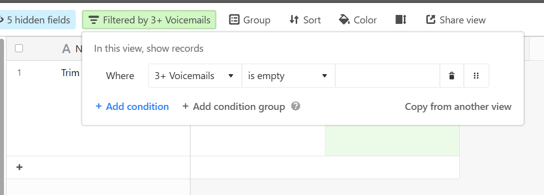

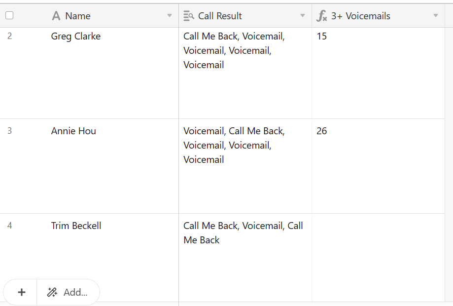

When I replicated the filter with a lookup field, it worked exactly as intended. We know the lookup field is filtering like traditional text because you are using the same field to filter out other text strings as well. However, Airtable might be getting confused by the complexity of your filter. You can try splitting up your filters into different condition groups to see if that has any effect.
But here's another way around this. Create a new formula field that uses a SEARCH function to identify the "Voicemail, Voicemail, Voicemail" pattern, then add a filter that catches the empty fields.
SEARCH("Voicemail, Voicemail, Voicemail", ARRAYJOIN({Call Result}, ", "))

Thank you for that suggestion @AirBenderMarcus - this worked perfectly for me. Thank you and also I appreciate the effort you have gone to replicate my issue on your end to find the solution.
I can confirm that even after removing other filters as suggested I was unable to filter by multiple Voicemails using the Lookup field - so I am glad you provided the alternative.
Marking this as solved and thank you so much once again.
