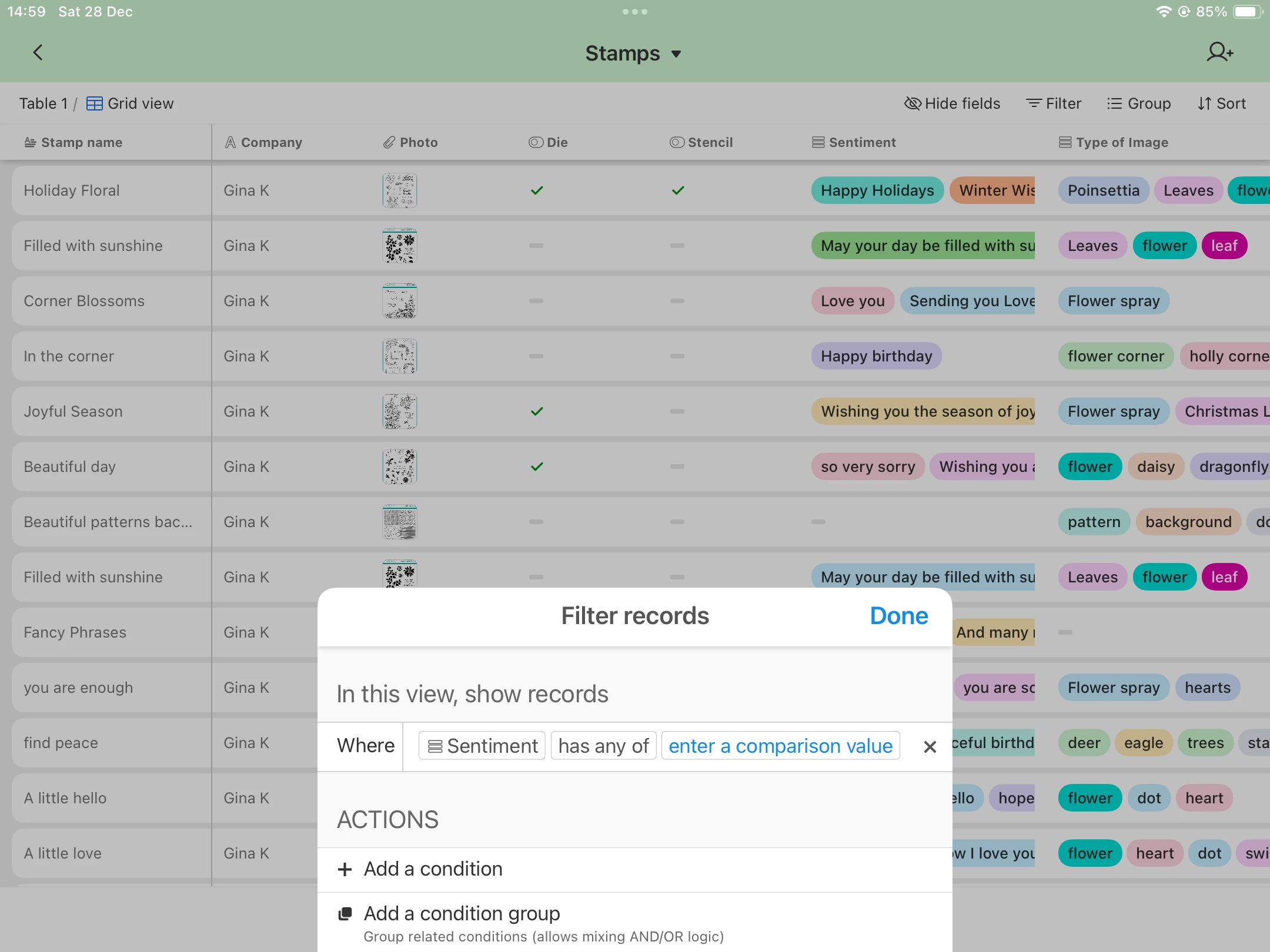

I am new to the free version of Airtable which I am using to keep track of my craft stamps. I have at the moment around 500 items which have sentiments listed. When I try to find a particular sentiment I search for eg has any of, but it gives me "enter comparison value" and all the sentiments I have created. What I want is just a search box so I can just type just one word eg happy, so all those sentiments are found. What have I done wrong please and how can I rectify it.
Sorry how do I filter by status? I don’t seem to have that option .
I’m using the free version would that matter?

Thanks for the reply. This is the choice when I filter. The field type is multiple select. You can see on the headings I don’t have a drop down box either.
Ah, you want to do a partial filter on a multiple select field!  To do that, try creating a formula field that'll output the multiple select field's values; this effectively creates a text version of the multiple select field's values which you can then filter by:

Ah, here are some step by step instructions, sorry for the confusion!
1. Create a 'Formula' type field: https://support.airtable.com/docs/formula-field-reference
2. In that field, reference the 'Sentiment' field.  It should look like this:
3. In your filters, use that new formula field which should now let you filter by 'contains': 
And I've updated the base to match 

Thanks so much Adam that worked great. Looked at the academy and it blew my mind. I don't think I need to know that much depth for organizing my craft room. but thanks again, I really appreciate you taking the time to help
