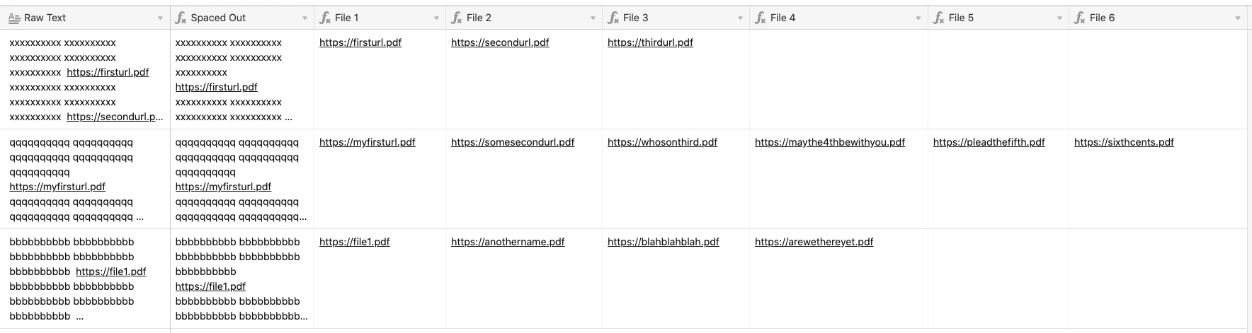

Thanks for the additional info. Not knowing more about these emails, it’s probably safe to assume that they’re all different enough that finding a pattern in them isn’t going to be nearly as straightforward as it was with the attachment field URL extraction. Thankfully that doesn’t mean we’re out of luck. When a single formula becomes too much of a headache, I switch to using multiple formulas.
The first formula will pad a ton of spaces around each URL, which will allow us to grab each URL as a somewhat arbitrary chunk, then trim the extra spaces off the ends. I named this field {Spaced Out}:
SUBSTITUTE(SUBSTITUTE({Raw Text}, "https", REPT(" ", 100) & "https"), ".pdf", ".pdf" & REPT(" ", 100))
Now we’ll add enough formula fields to extract all the URLs. The first one will search for the first instance. I named this field {File 1} :
TRIM(MID({Spaced Out}, FIND("https", {Spaced Out}), 100))
Each formula field after that finds the next URL using the previous one as a guide. Here’s {File 2}:
IF({File 1}, TRIM(MID({Spaced Out}, FIND("https", {Spaced Out}, FIND({File 1}, {Spaced Out}) + 5), 100)))
{File 3} is the same formula, but using {File 2} as a reference:
IF({File 2}, TRIM(MID({Spaced Out}, FIND("https", {Spaced Out}, FIND({File 2}, {Spaced Out}) + 5), 100)))
And so on through the rest. In the end, you have all the urls extracted in separate fields:
If you have URLs longer than 100 characters (doubtful, but possible), you’ll need to increase the “100” in each of those formulas to something a little larger.
