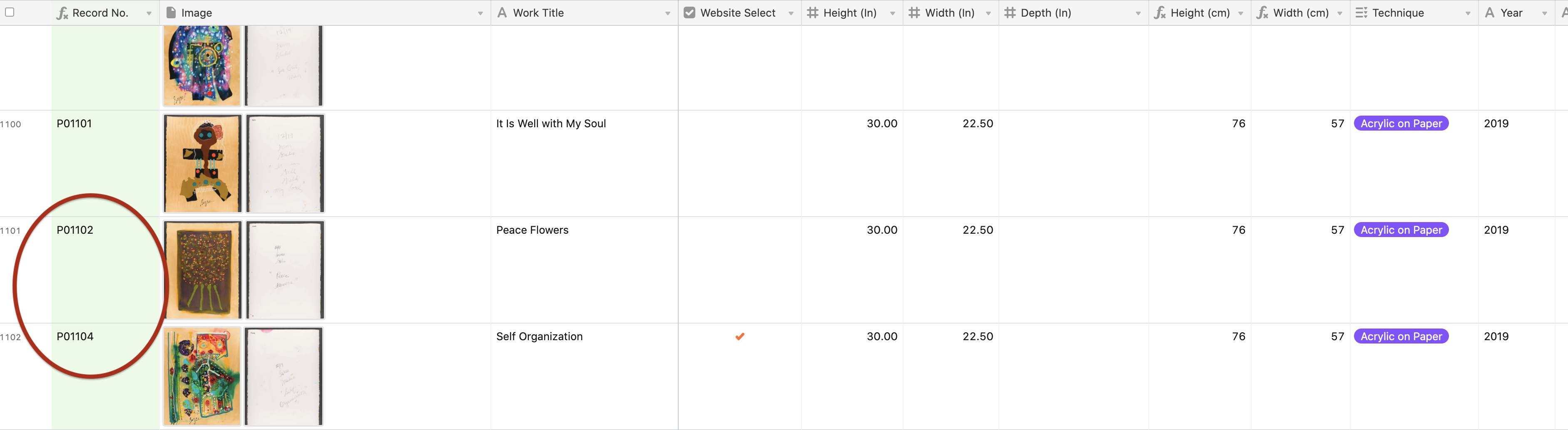

@andywingrave Thank you so much for answering back. Here is the way the table is setup. No linked tables.
Example of a missing record. The scripting block sounds like a good idea. I have no scripting experience but can start looking to learn what I need to get this done.
The record number in the screen capture is a formula that is a reference to a single line text field. It is a reference as a deterrent for users to change this by mistake.
