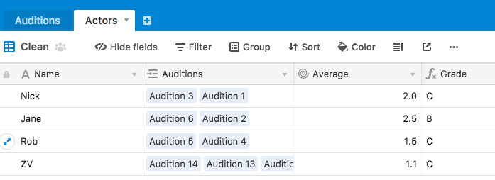

Do that in the Auditions table! Add a Formula field like in my example, and change the lookup of the Actors table to a Rollup field, selecting the new Formula as field and Average as the function.
I’ve updated the base:
  • Formula of the Rating in Auditions: IF(Grade = "A", 3, IF(Grade = "B", 2, 1))
  • Formula of the Grade in Actors: IF(Average = 3, "A", IF(Average > 2, "B", "C"))
You can adapt to match your needs.

You shouldn’t have those large strings “C,C,C…”, and “1,1,1.…”. The Rollup field in Actors table does the listing (internally) and average at once.
I’ve added data for “Actor ZV” in the demo base, and my Average field says 1.1 (9/8 = 1,125), and of course a Grade of C.
Also, you shouldn’t have the final “0,0”, I think you have some blanks processed by the formula.

Again, you don’t need to do a Lookup and get those long strings.
  1. You make the conversion from letter to number in a Formula field in the Auditions table, let’s call it Rating.
  2. In the Actors table, create a Rollup field (let’s call it ‘Average’) to the Auditions table, selecting the Rating field and AVERAGE() as the formula.
  3. Create a Formula field in Actors table (let’s call it ‘Grade’), that converts the Average field number into letters.
This steps can be seen in my demo table. I don’t know what you are doing :man_shrugging: Why this is not valid?
