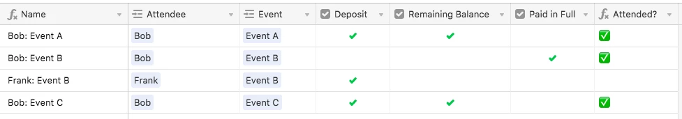

Create three tables: [Attendees], [Events], and [Orders].
Orders would connect attendees with events, and would be where you track payments. Here’s how I set mine up:
The formula in the {Attended?} field is this:
IF(OR(AND(Deposit, {Remaining Balance}), {Paid in Full}), "✅" )

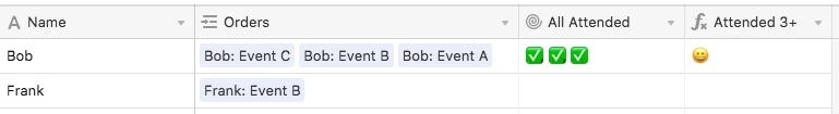

Back in the [Attendees] table, I’ll roll up that {Attended} field using ARRAYCOMPACT(values) as the aggregation function. In case someone doesn’t meet the criteria to count as having attended, those blank responses won’t appear in the rollup.
I’ll then add a formula field to count the number of check marks rolled up, and display another emoji if it’s 3 or more.
That final formula is:
IF(LEN({All Attended} & "") >= 3, "😀")

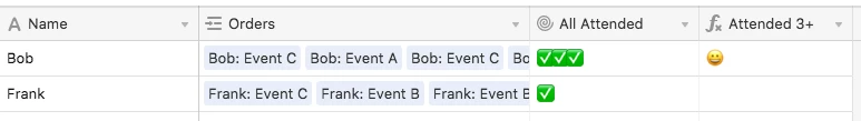

Having things in separate records definitely makes it trickier, but not impossible. Before diving into the changes, I want to explain the logic I applied.
You’ve been saying so far that you want to count [A] + [B] (deposit payment + balance payment) as a single attendance indicator. However, unless I’m missing something, there will never be a situation where someone makes balance payment [B] without having made deposit payment [A] first. Therefore, we can effectively ignore the deposits and only count the balance payments. In other words, all balance payments plus all full payments equals the number of times that person attended.
With that in mind, here’s an alternate setup for the Orders table:
The new formula for the last field, now named {Status} is:
IF(OR({Remaining Balance}, {Paid in Full}), "✅")
That field is still rolled up in the {Customers} table, but with a different aggregation formula. Adding ARRAYCOMPACT into the mix removes those blank values for the deposit records, leaving only those for balances or full payments:
ARRAYJOIN(ARRAYCOMPACT(values), "")
With that, the final formula field changes to this:
IF(LEN({All Attended}) >= 3, "😀")
