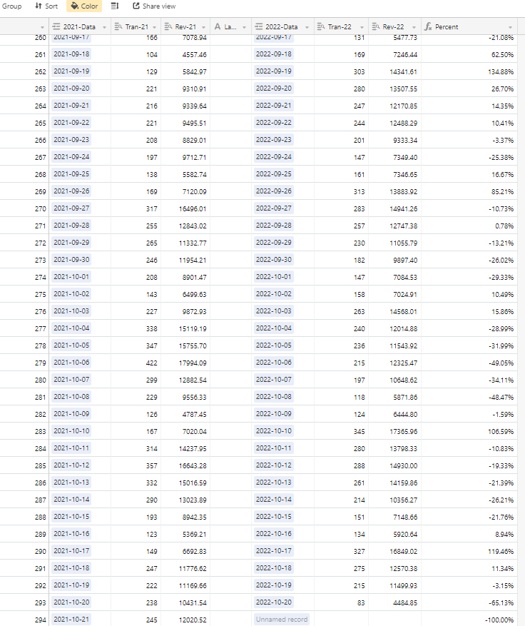

Hello, I’m trying to find a way to get a cumulative sum from the last 30 days that needs to be updated daily.
This is all I have at the moment.
(PS: The numbers on the left are IDs.)

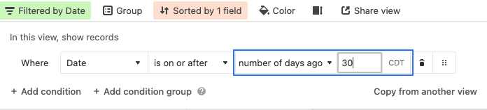

Another way would be to create a View that filters to only show records from the last 30 days:
And then just look at the summary bar at the bottom every day to get your updated value (records that are 31 days old and older will automatically drop off the View at Midnight in the selected Timezone).

Thank you for your response. However, since I am currently unable to extract the sum, how would I go about changing the formula to make it cumulative? Any assistance would be greatly appreciated.
