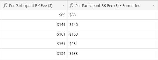

Thanks, @Justin_Barrett. The field type is currency formatted to 1 as the precision. It formats fine in Airtable. However, I am using Stacker for the the front-end and when the value (without the formula above) gets passed to Stacker the formatting goes away and I am left with the amount including decimals. So I created a an additional field with the formula above and {NumberValue} which works when passed to Stacker. I’ve included a screenshot below. You’ll notice the first 3 records round down (e.g. $89 -> $88, $141 -> $140, and $161 -> $160), but the 4th record does not ($351 -> $351). I suspect this is because the 4th record was somewhere between $351.00 and $351.49 while the first 3 records were greater than .5 (e.g. $88.70). Really appreciate your help.
Thanks for the update (and apologies for the delay), but your screenshot doesn’t show the {NumberValue} field, so I’m still not certain how that plays into this. The actual number (formatted via Airtable’s field formatting) is already in the {Per Participant RK Fee ($)} field, so why can’t that be directly used in the other formula? Why is {NumberValue} necessary to make this work?
On top of that, the formula you listed in your first post is fairly complex because it’s designed for larger numbers, but in your screenshot, none of the numbers is larger than three digits. What’s the largest number that you anticipate needing to format? If it’s under $1000 (and never negative), then you can get by with a much simpler formula.
@Justin_Barrett Sorry for the confusion. The {Per Participant RK Fee ($)} is actually used in the formula instead of {NumberValue}. I just used {NumberValue} as an example - it doesn’t actually exist in my Airtable or the formula. So as an example, the formula would actually look something like then when that field is referenced.

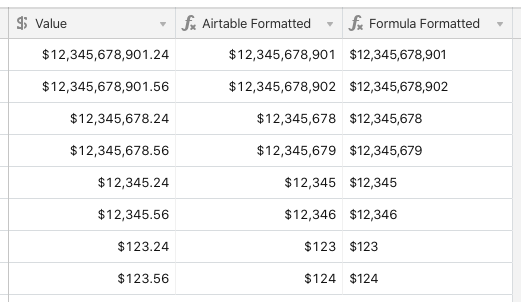

This was trickier than I thought, partly because I had to reverse-engineer not only what the original code does, but why it does it. That said, I got this working successfully in a test table:
The {Airtable Formatted} field just echoes the number from {Value}, and formats the field using the Currency option with precision set to $1, which auto-rounds for display purposes. That’s what I knew I had to match when building the formatted number.
You said that your values could be into the billions, so that alone meant reworking the formula a bit because it was only designed to format numbers into the millions.
The first thing I did was take care of the rounding outside of the main formula, leaving the main formula to format that already-rounded number. I made a formula field named {Rounded}, using this formula, then hid it from view:
ROUND(Value)
The main formula in the {Formula Formatted} field is this:
