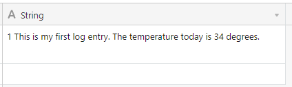

In Airtable, we have our record and field containing our string.
We’ll start filling out our formula. With this {String} field, we get:

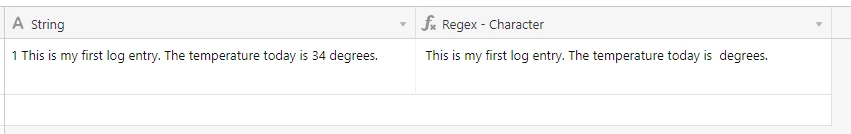

Here’s the final behavior:
Now, you will notice a strange behavior in the screenshot above. Even though we removed the numbers, there is an extra space between the words where the number(s) used to be.
This happens because the number(s) had spaces before and after the words they were between.
Let’s fix this.

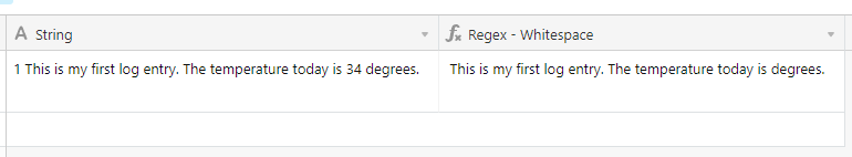

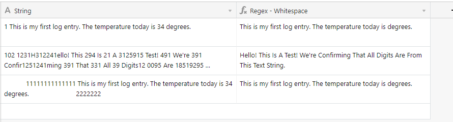

This is the final result:
I highly recommend playing around with Regex101 to see how changing the patterns and strings will return different results as you tweak things.
It’s a great learning tool. I would never have been able to get my head around regex without it!

We now have this:
There’s one last piece to this formula.
It might even be readily apparent.
Because there was a number at the beginning of the string, there’s actually a leading space at the start of the formula’s output.
This is what it looks like:
'  This is my first log entry. The temperature today is degrees.'

All we have to do is wrap our entire formula inside the TRIM() function like this:
TRIM(
    REGEX_REPLACE(
        REGEX_REPLACE(
            {String},
            '\d',
        '\s{2,}',
