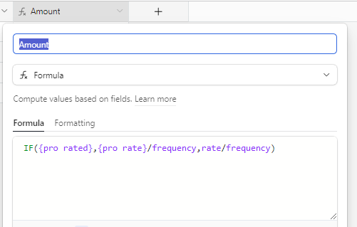

You could try something like that:
Formula for field "Amount" is:

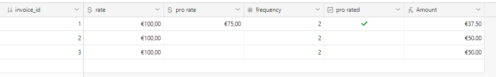

Hence if "Pro rated" is checked, field "Pro rate" is the numerator, otherwise field "rate" is the numerator.

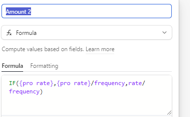

You could also do without the check box, and have a condition on "pro rate" value being provided or not:
