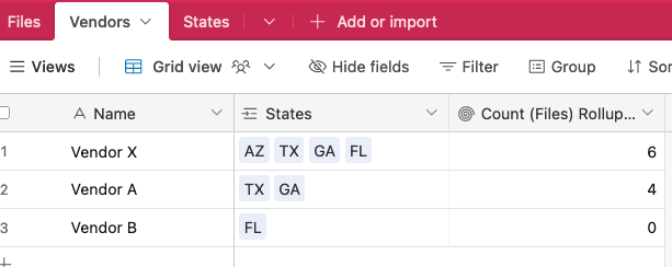

I am trying to use a formula for reach of our vendors on how many times a request has been sent to them by file number. I have them group by state so it show all the file numbers that went to that state. What I need it for vendor x to show that 70 request have been sent out because file number xwz have been order.
Example
Vendor X is in AZ, TX, GA and FL
Vendor A is in TX, GA
Vendor B is in FL

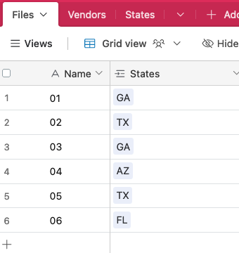

We have file 01 in GA, 02 in TX, 03 in GA, 04 in AZ, 05 in TX, 06 in FL
So Vendor X would have 6 orders, A would have 4 orders and B would have 1 order

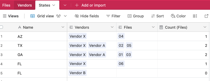

I think you're going to need 3 tables for this:
1. Vendors
2. Files
3. States
And "States" would have a linked field to "Vendors" and "Files"
You'd then create a "Count" field inside "States" to count the number of Files records are linked to that State record, and then you'd create a "Rollup" field inside "Vendors" to sum up the number of Files per Vendor
