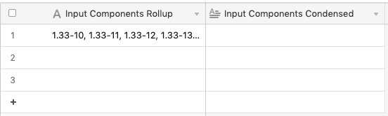

I am looking to take a long string of comma separated numbers (it is a string from a look up). Here is an example of numbers to summarize:
1.17-01, 1.17-02, 1.17-03, 1.17-04, 1.17-05, 1.17-06, 1.17-07, 1.17-08, 1.17-09, 1.17-10, 1.17-11, 1.17-12, 1.17-13, 1.17-14, 1.17-17, 1.17-18, 1.33-01, 1.33-02, 1.33-03, 1.33-04, 1.33-05, 1.33-07, 1.33-08, 1.33-09, 1.33-10, 1.33-11, 1.33-12, 1.33-13, 1.33-14, 1.33-15, 1.33-16, 1.33-17
If you look closely, there are missing numbers. I am hoping to find a formula that will output:
1.17-01 --> 1.17-14, 1.17-17, 1.17-18, 1.33-01, --> 1.33-05, 1.33-07, --> 1.33-17
I am flexible on the “–>”, but as you can see a simple dash won’t work, because dashes exist in the numbers. Has anyone seen something like this before? Any help would be greatly appreciated!!

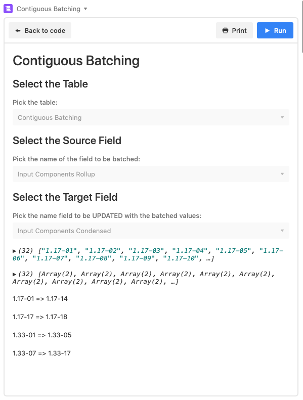

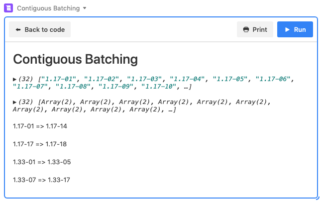

Yep - I think I see the rules and I’ll be the first to go out on a limb and suggest that without Split() in the formulas toolbox, this problem cannot be solved in a formula. And if someone does by chance nominate a solution, I’ll bet a fine turkey sandwich that it won’t be a practical solution.
The rules seem simple -
  1. Sort the unique IDs to create sequential [ascending] order.
  2. Batch the contiguous items
Given the sample data, is this the outcome you’re looking at?
If so, here’s a script block that does this - code included below.

Bill, this is awesome! I wish I had given more details earlier. Now I need to pull from a field called “Input Components Rollup” and deposit in a new field called “Input Components Condensed”. Would you be willing to help with that? I am not a java script wizard, but I will do my best. Thank you!
Bill_French
Good to see we got the requirements nailed down. I’ll try to add that table/field selectivity to the process; slammed today so a little later perhaos.
Thank you for you willingness to help Bill! I regret not putting all of the details for my application and sincerely appreciate your insight!

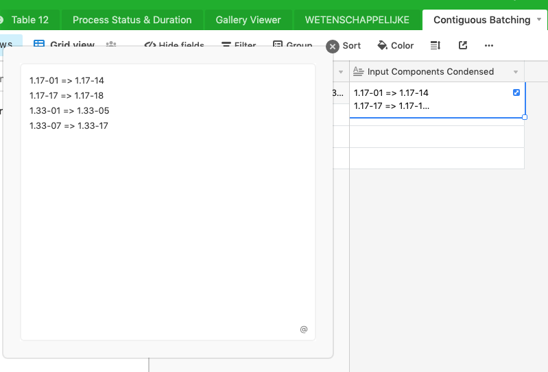

@Bill.French, this is fantastic work! It accomplishes 99% of what I was looking for. The only major issue is that if there is only one item in a series in the Input Components Rollup field, then it shows 1.17-01 => 1.17-01, which leads to duplicate and confusing information. For now, this still saves me considerable time and effort! I can just go back and edit the text output.
Thank you!
I think this script is an awesome candidate for the nee “Button Field” contest! A few comments I would make to potentially improve this script:
  1. Allow a view to be selected instead of a full table.
    It is amazing the flexibility you built in to select any table and any two fields! I love it!!! However, it is a pretty slow script. We have about a thousand records in one table and it takes almost a minute to run the script. Being able to select just a single view would reduce the necessary resources considerably.
  2. Separate the groups by commas instead of new lines. The primary reason for this script is to condense the information into a smaller space and improve readability. I mostly want it to use in a nice Page designer and the new lines expand the data to take even more room than before with long discontinuous lists.
  3. If using the button field, it could either clean up a field in the selected record or a field in all linked records in another table. I would prefer the second option. This would be even better than a view selection!!
I sincerely thank you for your volunteer time on this! I mean no disrespect in my recommendations. The script as is meets all of my most pressing needs. I just can’t help but share the ideas you helped me have! Gracias!!

{Input Components Condensed},
‘\n’,
)-2
Thanks!
Thank you!
You’re welcome and non taken. This is the world of fluid requirements because often we don’t know what’s possible.
But it also underscores the need for detailed requirements; we all agree they are beneficial, but the time it takes to think through all of the nuances is typically where developers and domain experts lunge forward without a clear pathway and outcome in mind.
