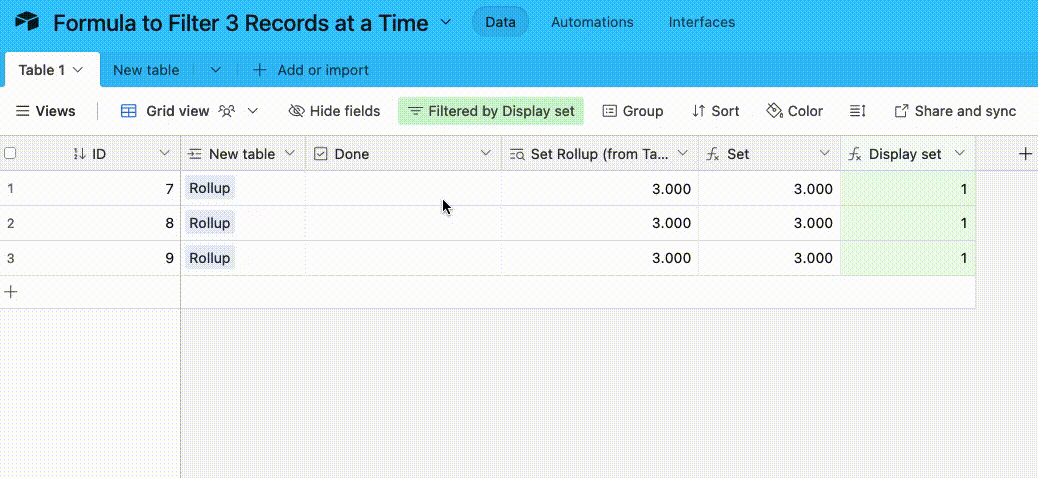

Hmm, if you're willing to link all your tasks to a single record in another table, check out this base
Idea is to have an autonumber field in your tasks table and have a formula field that'll help you create "sets" for your tasks.  You then ensure that all your tasks are linked to single record in another table, and then use a rollup field with the formula "MIN(values)" on the formula field I mentioned above, and make it conditional to only display records that don't have "Done" checked
You then create a lookup field to display that rollup field's value in the tasks table, and create a formula field to check whether the lookup value is the same as that record's set value.  Finally, create a view that'll filter based on that formula field

Wow thank you so much!
Is there anyway I can become an editor of that base so I can see how you created the formulas?

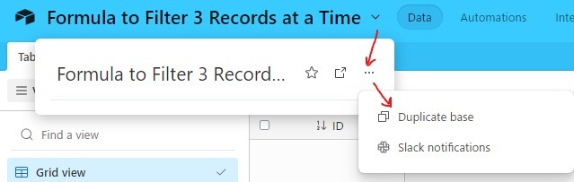

Great solution, @TheTimeSavingCo !
Thank you for sharing too
@Jeffrey_Brian
@TheTimeSavingCo shared the Base with us so you can duplicate it.

Okay awesome, thank you so much, I really appreciate it!!! @TheTimeSavingCo
