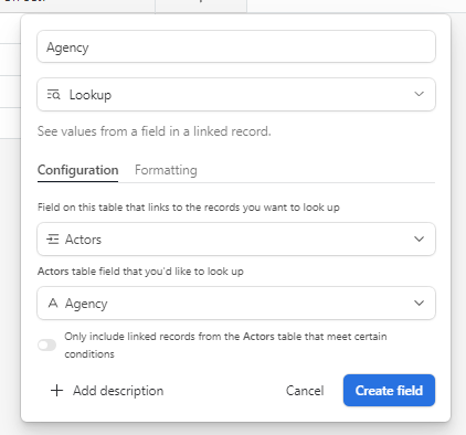

So if I understand correctly, Table A is the Parent information, with a field for Child.
Table B links to the parent and you also want it to show if that linked Parent has a child.
I believe a Lookup field might be easiest? If there is a value it will populate, if there isn't it will just be blank.
Something like this. I have Actors linked already, and here I can have it tell me if they have an associated Agency or not. Hope this helps!

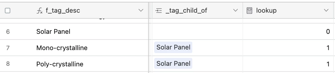

Thanks Shannon but it will not work because a lookup only tells me if the record has a parent not if the parent has a child. Same with Rollup and Count.
See in the attached screenshot how I need the first record "Solar panel" to show that it has children, not the two children to show that they have ยท"Solar panel" as their parent.

Oh I see the problem, it doesn't work the same when linking within the same table as it does between tables. Dang. I will play around, in the meantime hopefully a smarter person has an answer!
You can't do this with a formula I think, and will need to use a script for it
