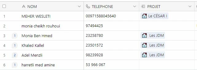

Hi
I need a function that I will use to count the numbers of the same value in a column here is an example that explains

hi
thank you very much for your reply
my final objective is very simple this interface is linked to a client table
I just want to distinguish the same duplicate customers (who have the same telephone number) either by coloring these customers for example or by blocking the addition of the same customer (telephone number already exists so block the addition of a customer with the same number)
thank you very much

The simple manual trick to deduplicate, or to get totals by some grouping value, is :
duplicate field and make it link to another table (new table).
In that table, primary field will be set of unique numbers, 'count' will show how many times this number shown in a column, lookup of Name will show all names for that number, and rollup SUM(values) of Calculation field will give you a total for given number.
  • January 2, 2024
it's a very good idea except that for new recordings it won't work
since the copy will not apply when adding new records
I just want a solution to distinguish or block the same duplicate customers (who have the same phone number)

to maintain a dynamic update, you need to adjust the procedure of adding new records (put value to link field also), or if it's impossible, add automation. for such autolinking, I usually use 'when record matches condition' - 'number field not empty, link is empty', then simple update record action. other triggers are also possible, but it depends on use case. if you add new records by hand, it should not work as expected, because automation will run right after you put first digit in a field for number.
