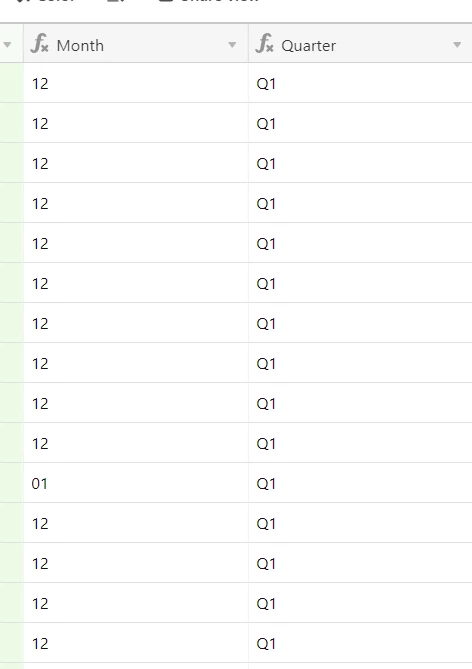

I have the following formula trying to pull the Quarter, but it shows Q1 for all the months. Example 12 is showing Q1 when it should show Q4.

Here is a picture of the column I am pulling from and the results which you can see the 12 are not correct as they should say Q4.
Im not sure, but it’s possible that it’s because 1 is part of the number 12.
Instead of using the FIND function, try using = instead.
For example:
IF(OR(Month=“01”,Month=“02”,Month=“03”),“Q1”)

That’s the issue. Each month numbers in the original formula should be wrapped in quotes.
The formula could also be rewritten as:
IF({Month}, "Q" & DATETIME_FORMAT(DATETIME_PARSE({Month}, "MM"), "Q"))
^ I suspect the formula can be even simpler. If {Month} is pulling from a date field, {Quarter} could do the same:
IF({Date}, "Q" & DATETIME_FORMAT({Date}, "Q"))
^^^ Smarter solution than mine.
Thank you both and got it to work using this!
