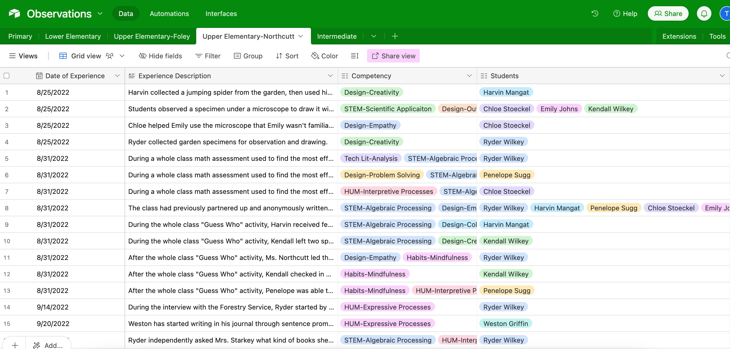

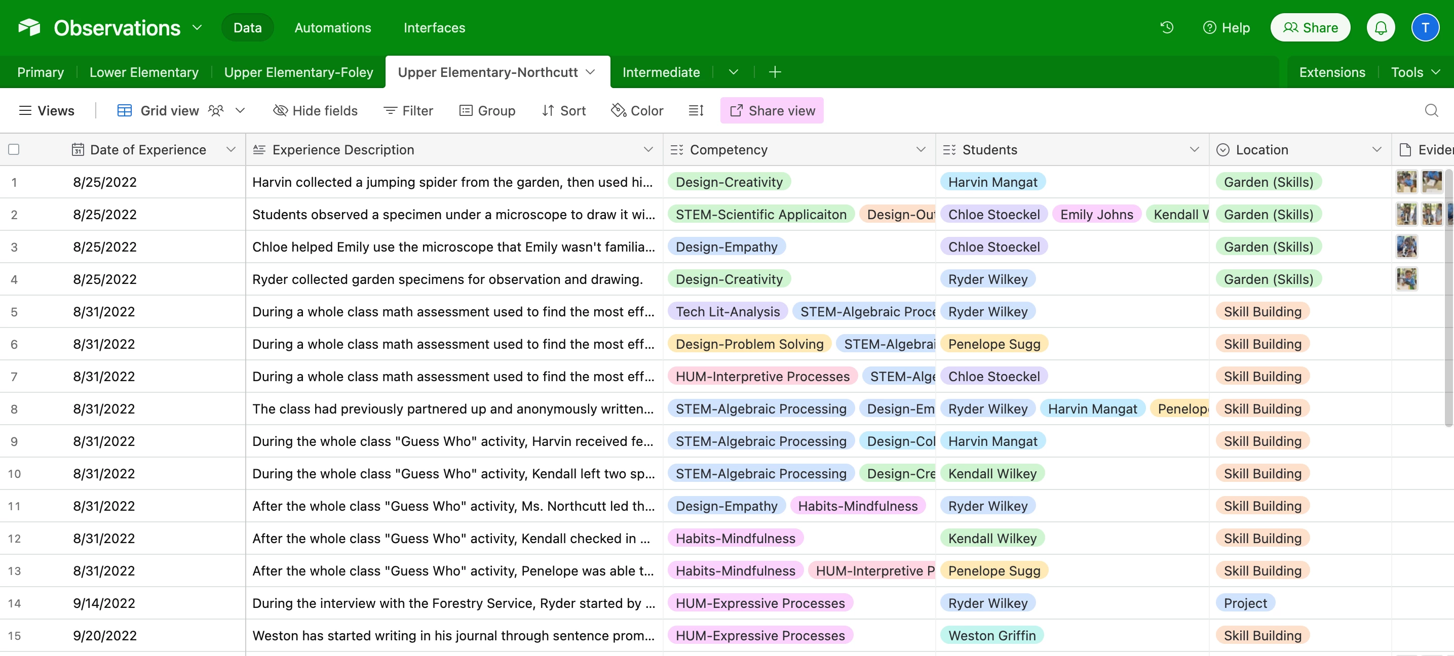

I am working on maintaining student learning records. I have two multiple select fields: one with "Student" names and one with demonstrated "Competency". I would love to create new rows for each combination of Student and Competency, and copy over the same Date, Experience Description, and Location. For example, record number 2 on the screenshots,, I would like one record with the same date/description/location for Chloe/STEM-Scientific Application, one record with the same date/description/location for Chloe/Design-Outcome, one record with the same date/description/location for Emily/STEM-Scientific Application, Emily/Design-Outcome, one record with the same date/description/location for Kendall/STEM-Scientific Application, and one record with the same date/description/location for Kendall/Design-Outcome.
